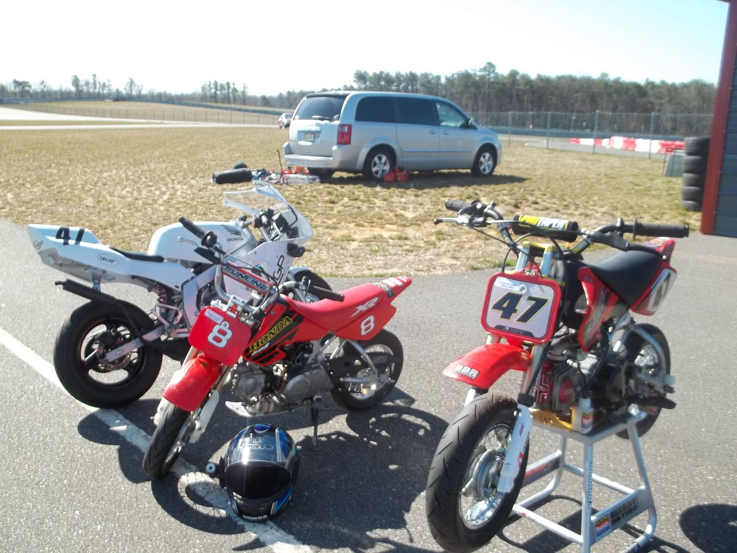

Great Carb..
I actually purchased a Second To have as a Spare in case I have any problems when Racing..
I bought my bike used with TB 88cc Kit ..I “think” I have a Race Head as it has TB on it and the cooling fins look bigger then my Sons stock 50 head.
Stock Jets Still Installed...in Tb20mm carb
The bike did not run right when I got it....3rd gear bogging..
The Bike Came With a Metal Mesh Air Filter.
Carb Cleaning..Did Not Fix It...(plans were to change jets..
At a Race First Time With Bike On Track..
Installed a RED FOAM AIR FILTER and New Spark Plug..the Bikes a BEAST
Fixed,runs great.
Has RED FOAM AIR FILTER ON BIKE NOW.
