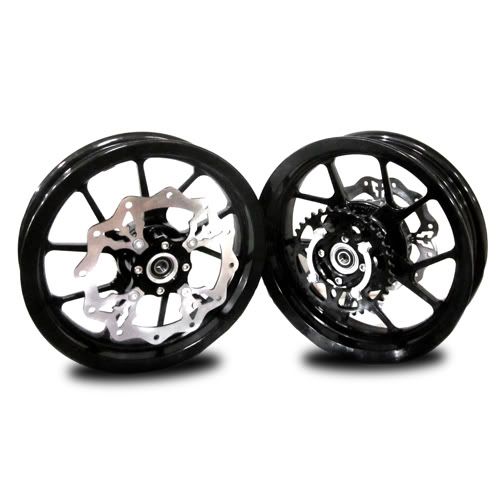

Fresh in today, new Mag Supermoto Wheel Kit for your Pitster Pro or other Import Mini. We are offering the first few buyers a special Promotional price of $210 (plus shipping).
Click Here Now to buy and see full specs.
Turn some laps in style with the Pitster Pro Mag Wheels. These come ready to go on your X2, X4, or LXR Pit bike but will easily fit most applications using a 15mm axle. This kit comes with wheel spacers making the swap a breeze to your Pitster Pro (spacers can be mixed with your OEM spacers to fit your application).
Specs:
Front Wheel is a 2.5x12"
Rear Wheel is a 2.75x12"
Kit includes:
-Front and rear wheel spacers
-220mm front rotor
-190mm front rotor
-37T/420 Rear Sprocket (we stated they came with a 39T front sprocket but actually its a 37T)

chester3000 said:
Specs:
Front Wheel is a 2.5x12" with 15mm Axle @6.7lbs (with rotor)
Rear Wheel is a 2.75x12" with 15mm Axle @ 8.5lbs (with sprocket and rotor)
From the above link..... :D
Schwank, I'll have to weigh my NSR50(ish) wheels for comparison. I'm rather tempted by the idea of that front wheel mated to a set of road race tuned 5" travel Shivers on my CRF70 given the number of mini-motard racing opportunities I'll have next year...
#25 ·
goodwin said:
sdg is 12mm but theres got to be a way.....
Which SDG are you looking at? All SDGs, the Pro Mini, Speed Mini and Lil Mini were 15mm, they were the originator of this axle/hub setup. At most you might have to tweak or use your stock spacers and you'll need to reuse your smaller existing rotor if you've got a Speed/Lil Mini with 36mm conventional forks and a single piston front caliper, but otherwise the wheels should bolt up.
