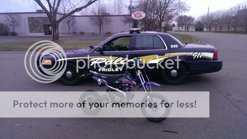

Hey Guys and Girls
Back in September I bought a SSR125sr from Tbolt and have been making it street legal. Here in MN it was really easy to do through the DNR. After getting it plated through the DNR I actually found out I could take my MSO from Tbolt into the DMV and get a real title, so I did that too! :D
It has a headlight, tail light, horn, mirror and a couple other little bits but all in all was easy.
[/URL[URL=http://s1163.photobucket.com/user/mrjswans/media/IMAG0847.jpg.html]
