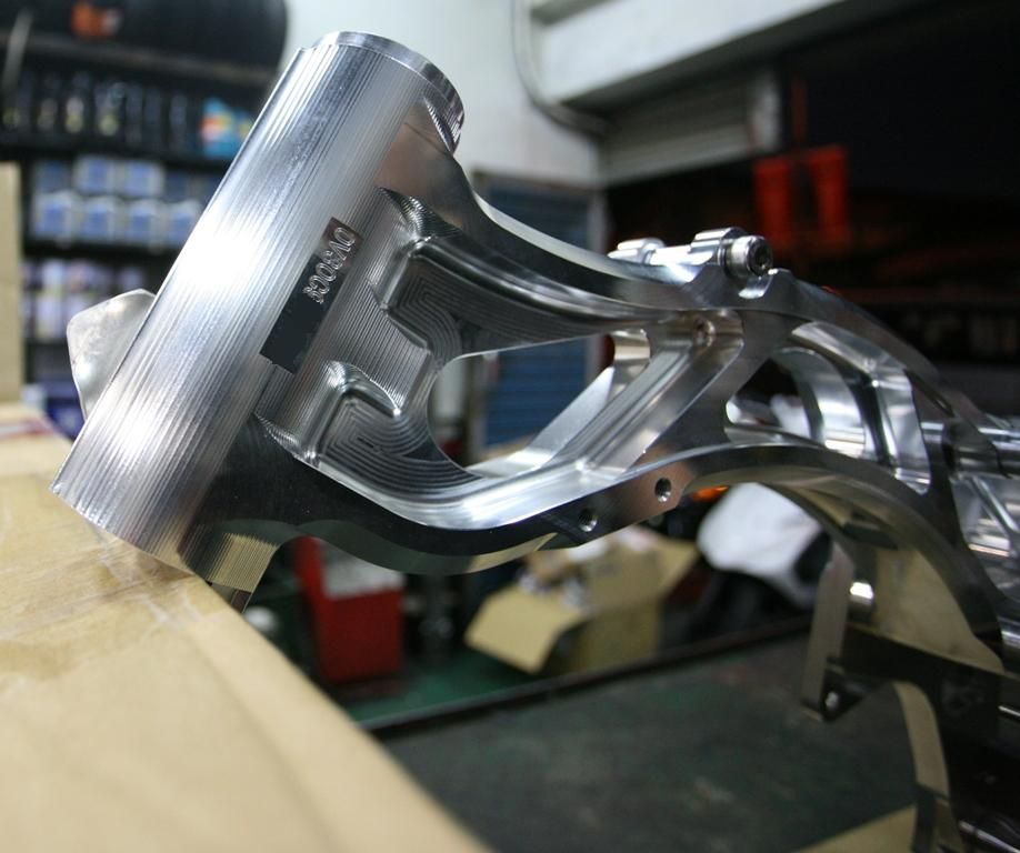

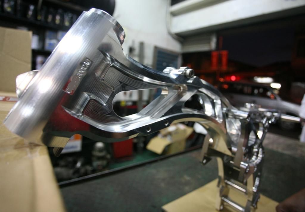

Thanks to Adam Z50+R, I was able to change to the correct part numbers in time before they send the parts from Japan. I change my dry clutch kit from the 4 clutch disk to the recent release 5 clutch disk. I have also order the 5 speed transmission to suit the Takegawa heavy duty crankcase. Ended up also ordering the 138cc Dohc kit and also the heavy duty crankcase. I am not sure when all the parts will get here since I am still waiting to find out. My guess is 1-3 weeks away.
With my OV-30, I wasn't happy with the side location of the Steering Damper that Over Racing have design for the OV-30 frame. My plan was to custom make my own bracket so I can install the steering damper just between the front fork and the gas tank. I decided to take my bike down to the CNC machine shop that I have used in the pass (for my titanium exhaust shield). The shop will custom design and make a bracket for my steering damper at the location that I want. It will end up costing me about $50-$80 extra, when compare to the steering damper bracket from Over Racing. Hoping to seeing the finish product in the next few days. Here is a photo of my titanium exhaust shield that the same shop have make (to prevent my shoe from melting against my exhaust).

Will post more update once I get my custom steering damper bracket back from the machine shop.
Discussion starter · #31 ·
Yes, it is no good at all. Wasn't expecting to take this long for the parts to get here.
I have pick up the custom steering damper bracket back from the machine shop.
The triangle piece install onto the front fork.
That is not gonna fit..... As you guys can see the second hole for the screw doesn't line up. The machine shop mess up and now I got to take the bike back to the shop for a new measurment and make sure they make it right this time:wink:
Hope they wont also mess up on my clutch cover since I aint paying for the mistake:p
