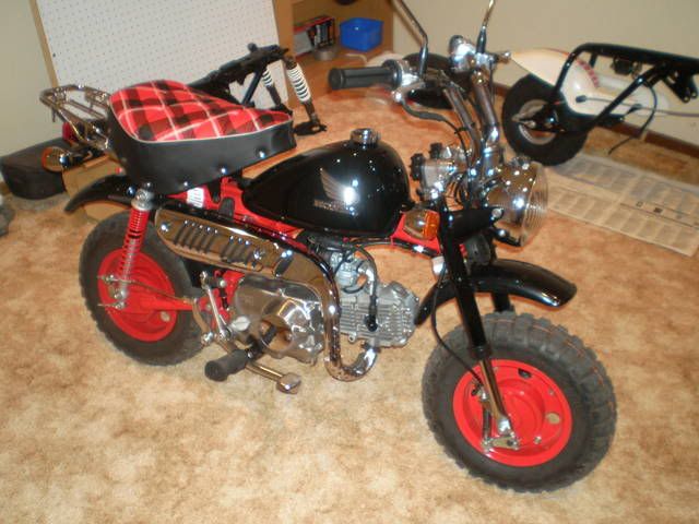

This is the 2007 40th anniversary edition, in all its ugly red and black glory!
After a few laps of the house, the bike was stripped in preparation for the frame change.
The red frame is the 40th, the black is the 1981 JZ.
The follow shows the few small differences between the frames. I made up some brackets to replicate the newer frame.
And so, with the extra brackets welded onto the old frame and some new black paint (I wanted to get rid of the red on the bike), I boted it all back up - now ready for road registration.
