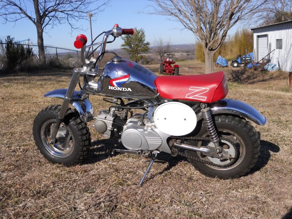

I picked up another Honda 50 last weekend. This one is an '86 Honda Z50RD "Christmas Special". These were made for one year only, and my understanding is that larger Honda dealerships received just one or two bikes each.
The bike is very complete and currently has a generic Chinese 50cc motor in it, but that won't be in there for long :D
I'm in the process of detailing everything, planning/performing modifications (stock sucks!), and prepping for a debut at a future Elvi ride. Here are a few photos which show how it looked when I picked it up - apologies for the cell phone picture quality. More to come as the project progresses...
#3 ·
The bike is very complete and currently has a stock style non-Honda 50cc motor in it, but that won't be in there for long :D

Good score 57 hotrodvw.....How much did you get it for if you don't mind me asking.One of my favourite Z's.
Thanks tmas. I'd rather keep the details to myself, but I think that I got a really good deal, especially given prices that I've seen for bikes that are nowhere near as nice as mine.

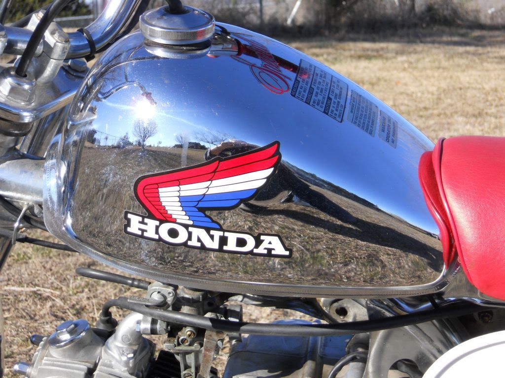

@_@ That chrome is stunning! Nice find.

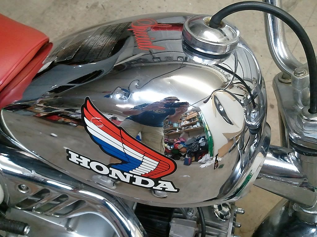

Other than some light rust on the wheels, the chrome is very nice all around. The tank has some dings in it, and I've heard that the aftermarket chrome Z50 tanks are not nearly as nice as the Honda ones.
I've spotted a couple of NOS Z50RD tanks, but their price is way up there (2.5 to 3 times dealer price when they were available), so I may have a local paintless dent repair shop have a look at my tank. I've seen them work their magic on my truck and was amazed.
--Eric

I'll definitely let everyone know what comes out of looking into/having paintless dent repair done on the tank. I had the pleasure of watching a guy work a very large dent out of the rear quarter panel of my truck. I talked to a number of good body shops first, and all said that there was no way to fix without body work. After ~1.5 hours and $125, you'd never know the dent was there, and I'm super particular.

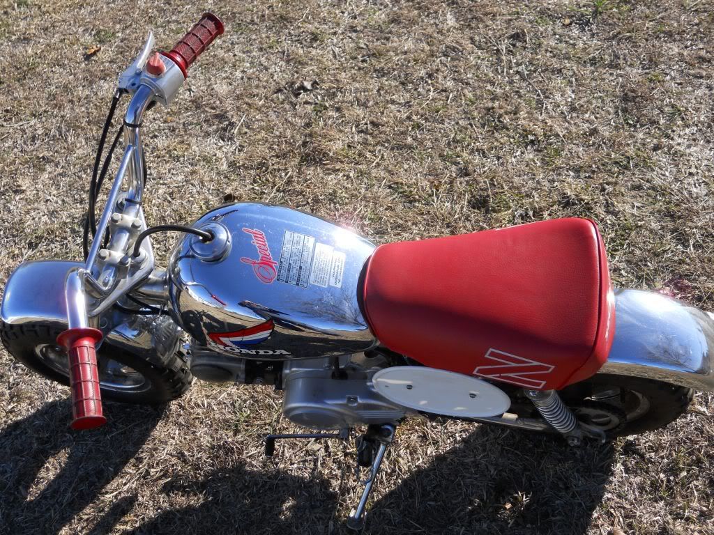

There's one for sale for $700 on the local CL. Doesn't look nearly as good as yours. I think the price is too high.
This one? It does look pretty beat...
1986 Honda Z50 Christmas Special (Chrome)

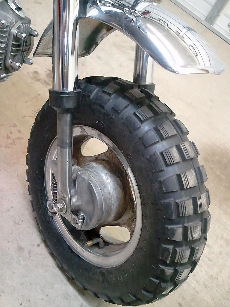

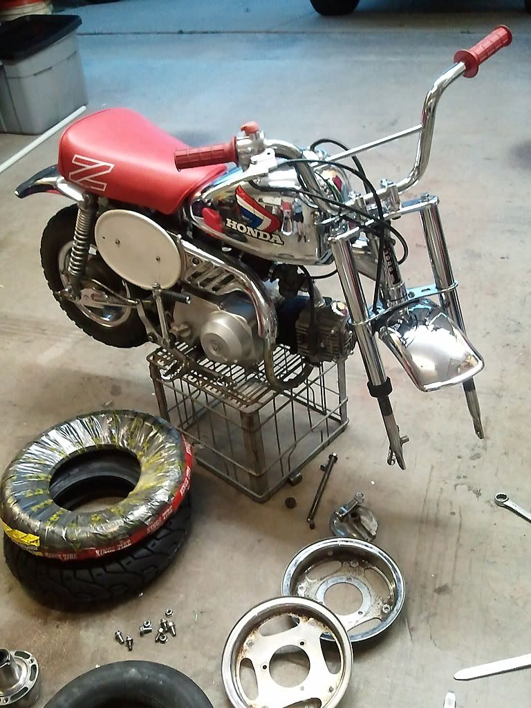

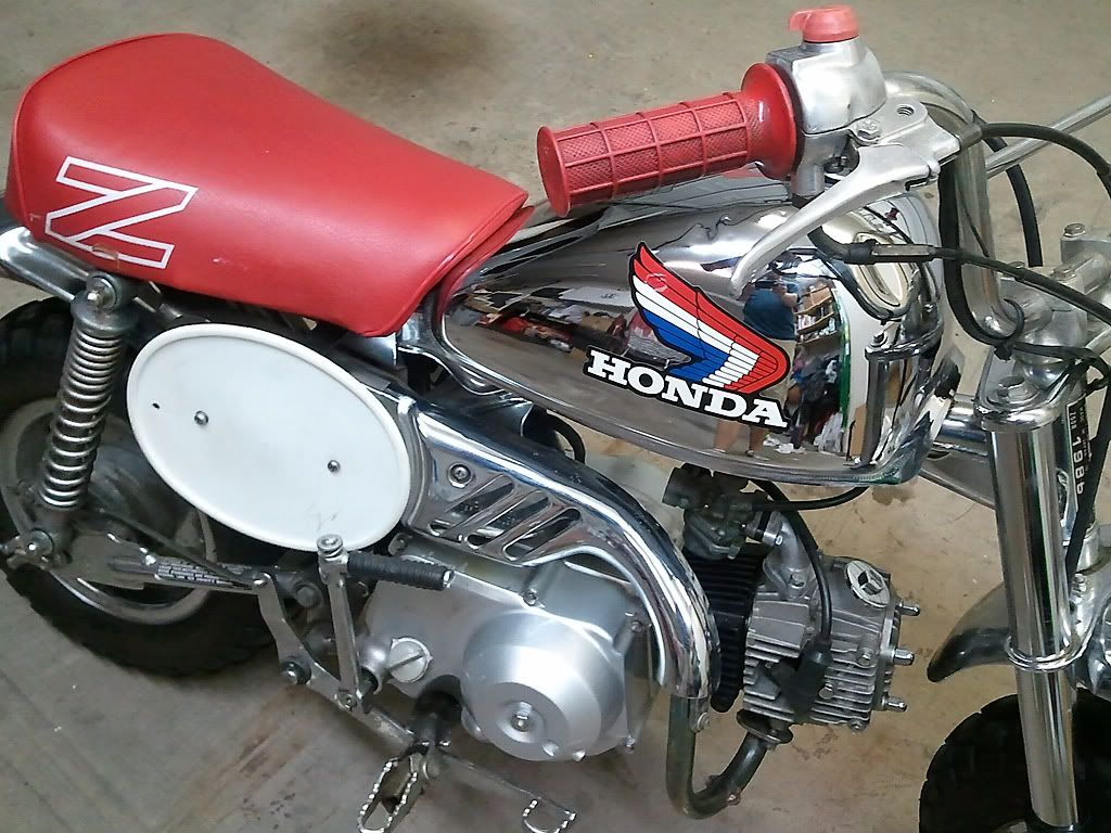

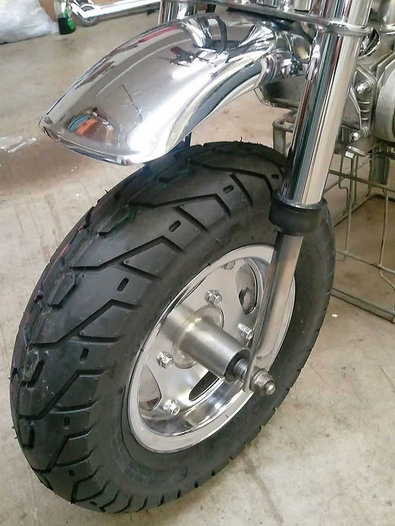

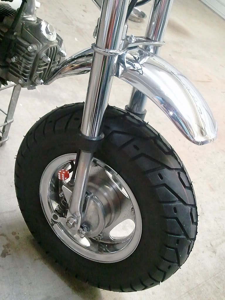

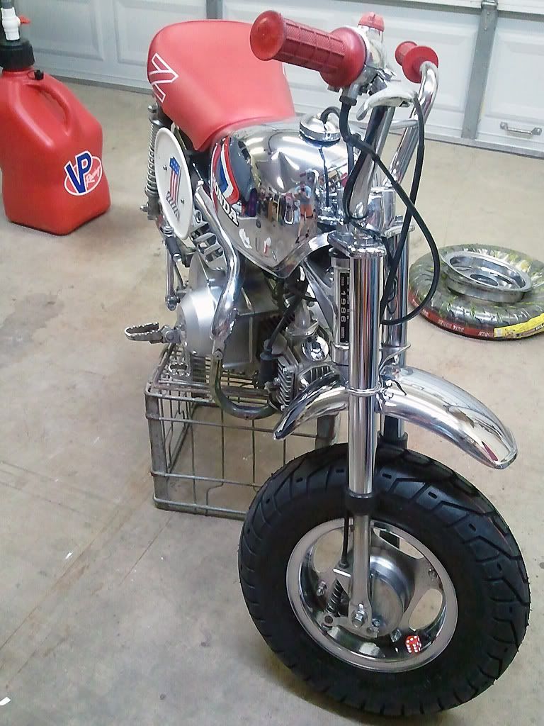

Continued the cleanup, detailing, and installation of a few new parts yesterday...

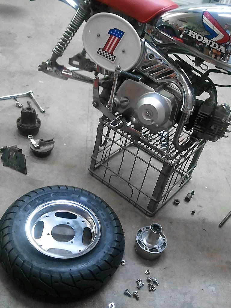

Rear wheel assembly back on the bike:
TB Parts 280mm shocks (thanks, Mike!)

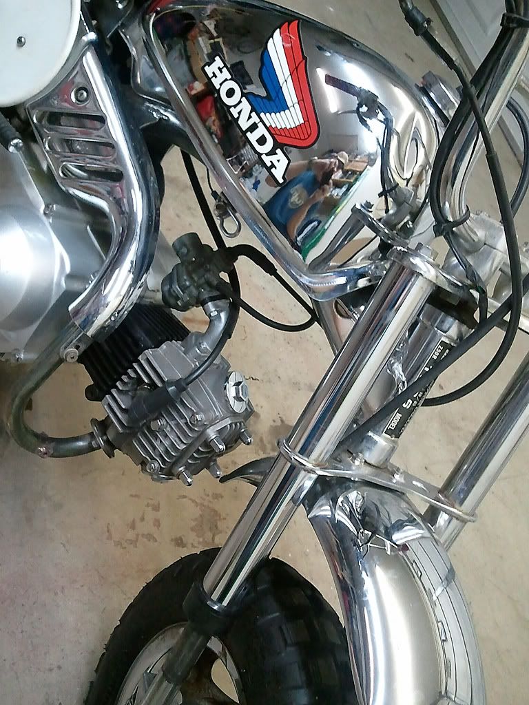

Front end disassembled and awaiting new +1 chromoly fork legs, HD springs, Delrin bushings, longer cables, and triple clamp:
Front end back together and new Honda front fender installed (Look Ma, no handlebars! :D):
