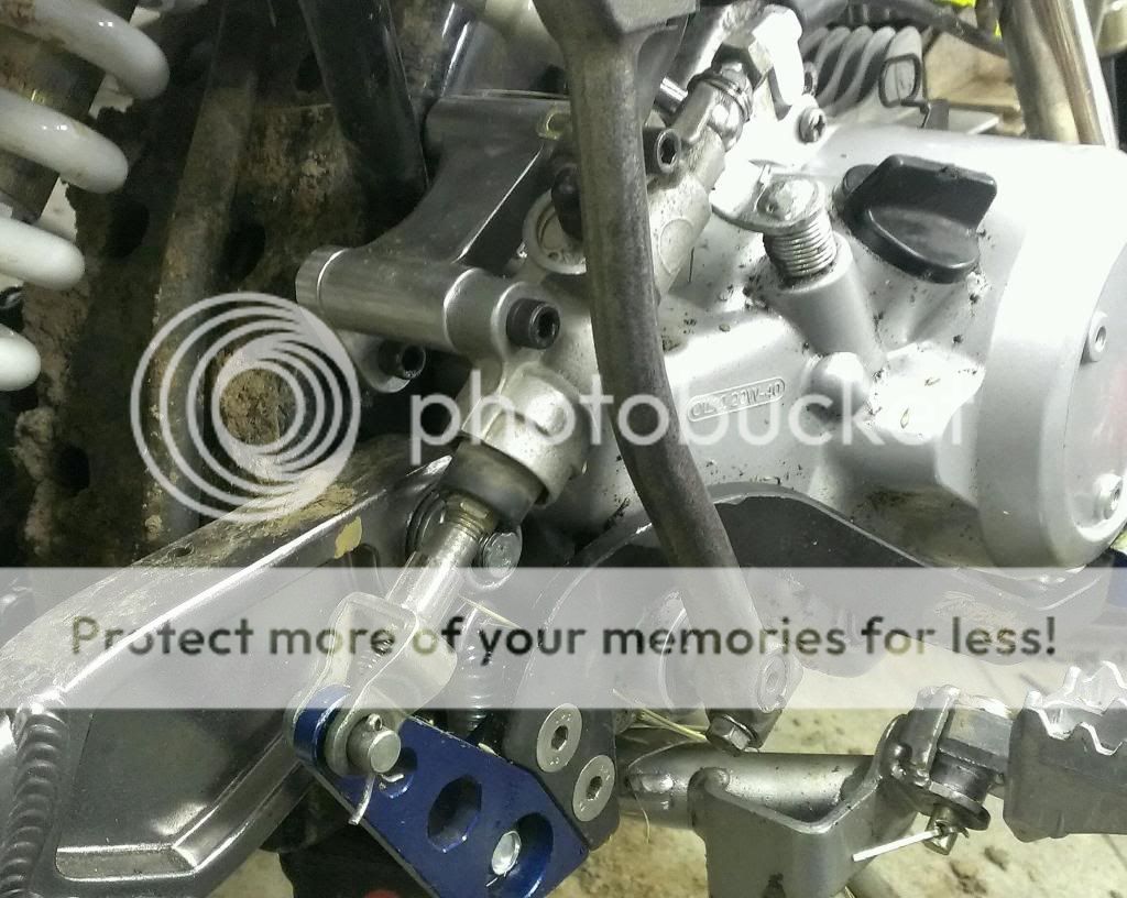

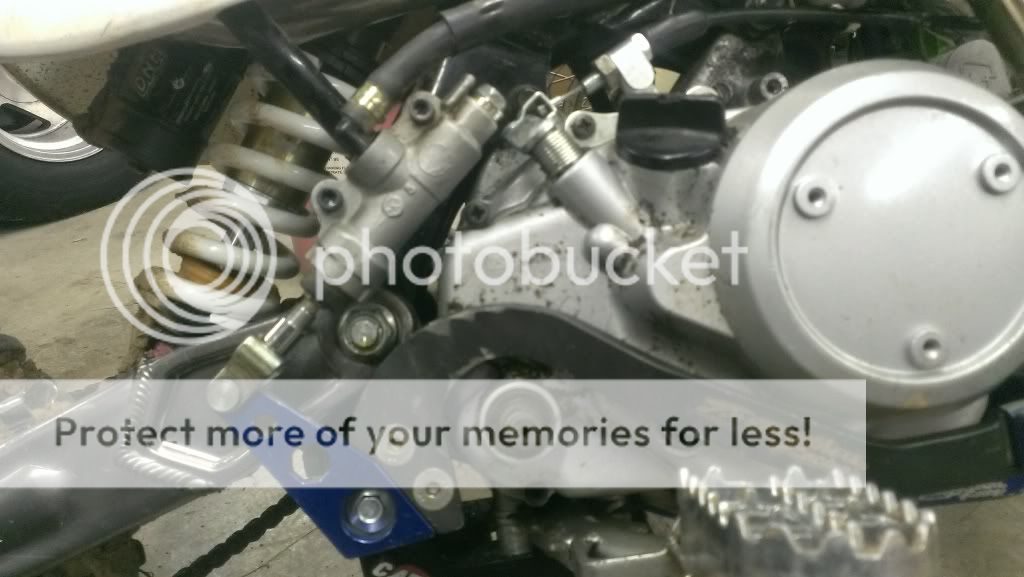

I made a bracket that looked like the ones that different companies sell. I have seen pictures of the kx 65 master cylinder mounted with this bracket but i sure as heck couldn't get it to line up. It may have just been the TBR brake pedal i am using. Either way it wouldn't line up with out hitting my cases. I made a bracket to fix that tonight. It allowed me to rotate the master cylinder around to line up with the pedal.
Here is my set up now. It seems to work great

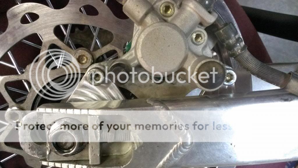

I also made a bracket to hold my rear caliper. The pictures i have of it are kind of lame though.

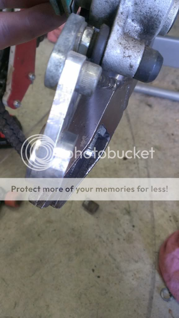

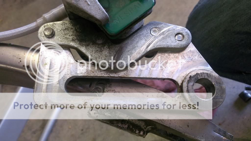

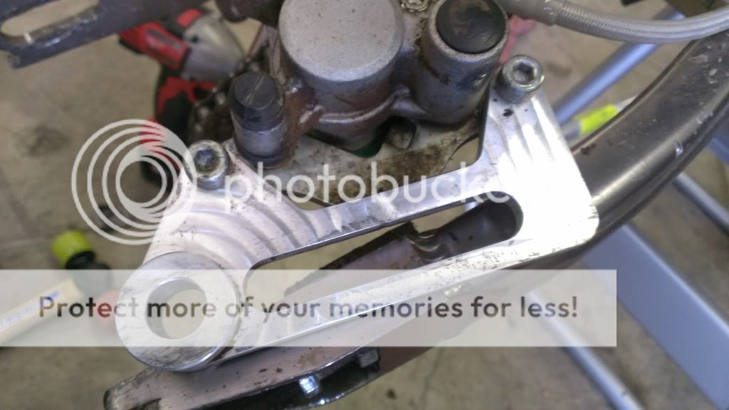

I'm more curious about the caliper bracket, I've never seen one not mounted on a bike...
I'll have to take it off of the bike to take better pictures of it.

It works perfect. Very solid. The stock kx65 brake line would even work with it but i didn't know that at first so i bought a longer one and now it may be too long.
