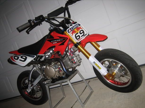

So I had a chance to stick the 108se on the dyno today. I am very happy with the results.....13hp. I will post up the dyno graph when I get home.

#11 ·
The motor is a Kitaco 108 Ultra SE. Here is what it has in it. It has OEM Honda cases w/high volume oil pump
Kitaco SE Head
Kitaco race cam
Kitaco high comp piston
Kitaco 51mm crank
Kitaco 24mm Carb Kit w/Unifilter and tank spacers
Kitaco Inner rotor Kit
Kitaco close ratio 3-speed
Kitaco Ultra clutch kit w/oil filter
Kitaco super ignition coil
ASV clutch lever
Takegawa Billet Oil Cooler
Two Bros Racing shifter
Ti-Force titanium pipe
**All runs were made on a brand new Dynojet 250i with Winpep 7 software**
