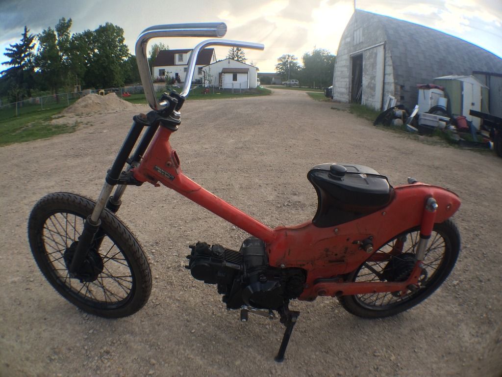

Soooo, 4 years later and I finally got around to doing something with this vintage scooter. Got anXR80 front end bolted on (need bearings), a Chinese 50cc bolted in for mock up (had to grind a bit of frame to get a newer style engine in there. Some cruiser bars on there for now, really looking for some beach cruiser style bars. Gonna build a solo seat from scratch, suicide shift and a 125 semi auto then powdercoat everything. Hopefully doesn't take another 4 years to post an update!

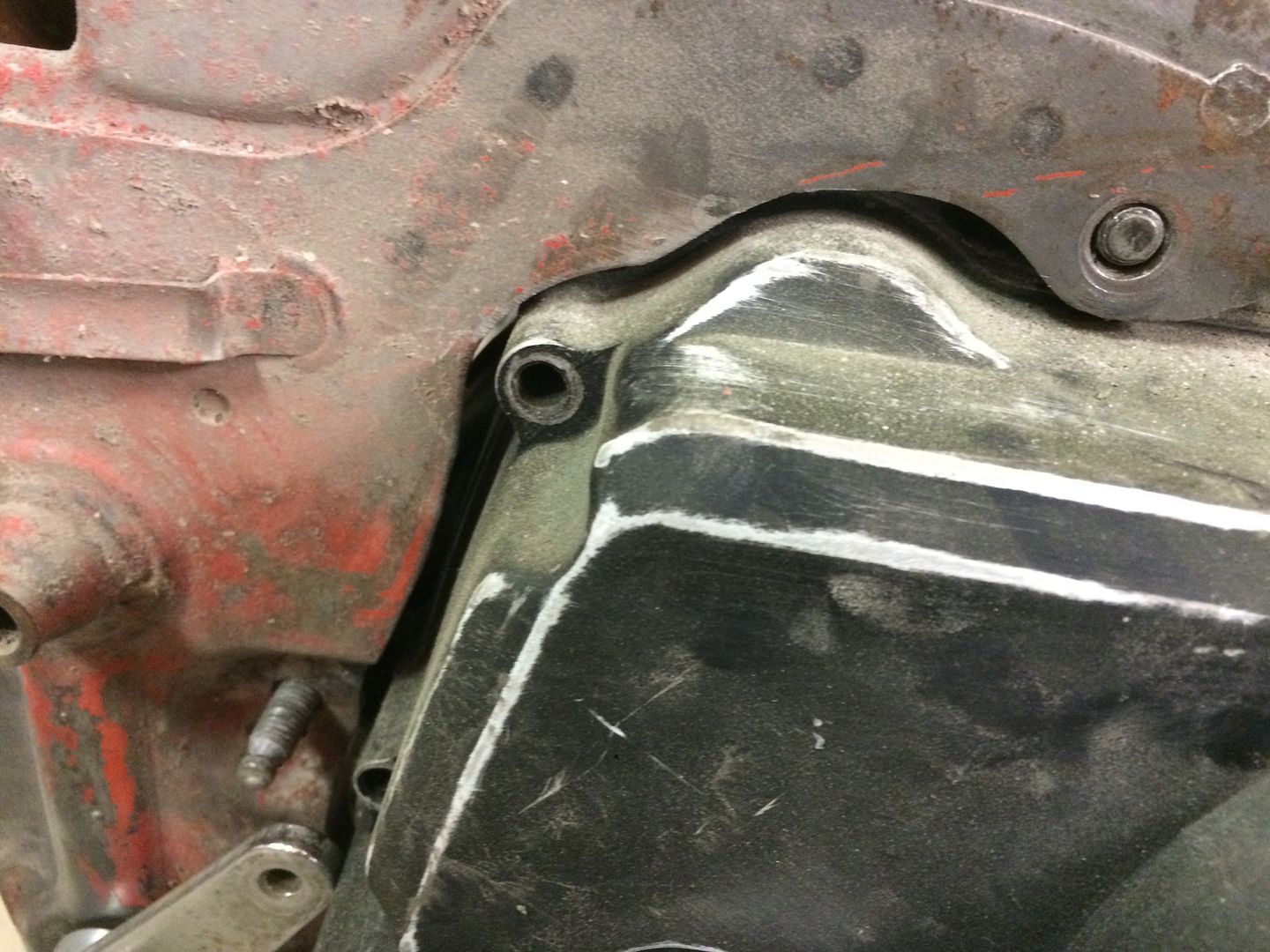

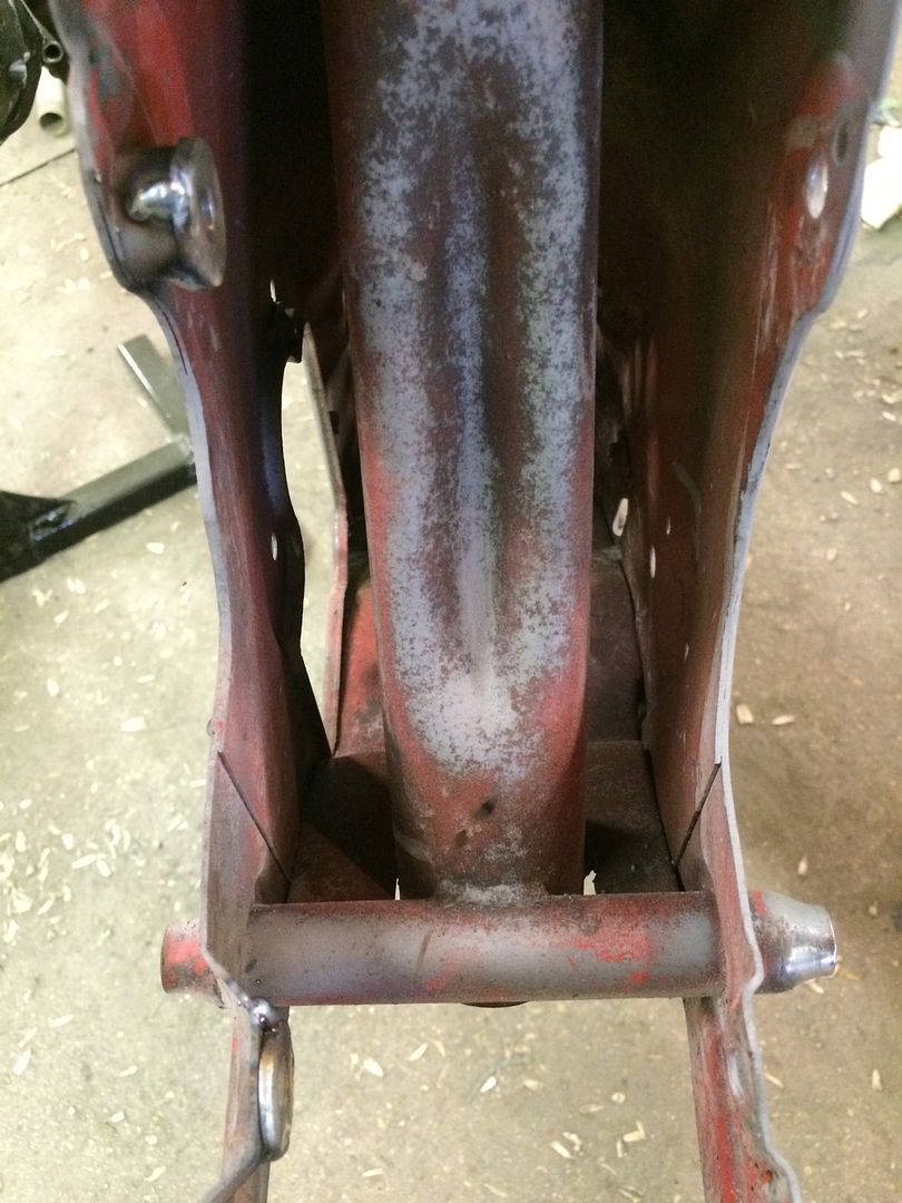

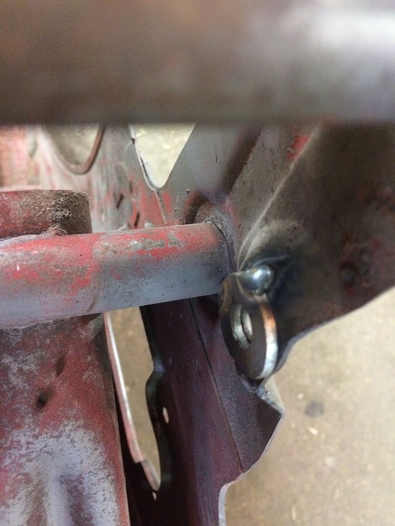

Finally got a chance today to tear the "bike" down to start the rebuild, I had to notch and cut the frame a bit to fit the newer OHC engines. Right meow I have a Lifan electric start 50cc in for mock up but planning on a 4 speed 125 semi auto.
I had to add some spacers so the newer engines will fit, guess the older push rod 50's had wider mounts.
After stripping the paint I noticed these spot weld marks that I'll have to fill and smooth out before powdercoat :thumbsdown:
