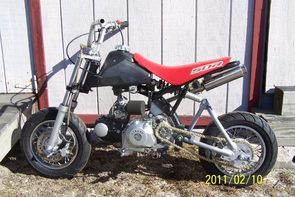

I've been talking about this and saving up parts for the last month or two. Got my motor today and couldn't help myself...dragged some parts into my storage room (its like 2 degrees in my garage right now) and started assembly. Hoping to ride it by the end of the week.
Started with a frame, fork clamps, and swing arm.
Stock crf rims (HD spokes on front)
Front hydraulic brake
1/4 turn throttle
Stock rear rim with stock spokes and drum brake
Stock plastics and tank
Cheap exhaust with half of the packing removed
Stock shock with big spring
Aftermarket forks, I have not identified a brand, but have put in bigger springs, new seals, and 80/90 gear oil for a very stiff front end
GPX140 motor with oil cooler (oil cooler not installed yet)
Mikuni 22mm carb (came with motor)
Pitster pro skid plate
Regina 420 chain
I have multiple front and rear sprockets
Modified crf50 peg mounts (raised the pegs up a little)
Upcoming modifications:
BBR HD spoke kit (bought it today, will put it on once a start breaking spokes)
Rear disc brake (so I can use my sdg +2" swing arm)
New adjusters for stock swing arm (have adjuster blocks for the sdg swing arm)
New chain guide
R6 foot pegs
Aftermarket exhaust (when I can afford one)
IRC street tires (using Cheng Shin now on my other bike as well, will replace with IRC when I install HD spokes)
There is more but I can't think of it...
Here are a few pictures of it slowly coming together in the messy storage room.
Thanks for checking it out! Ill put up some more pictures as I continue, and a link to some videos at some point.

Took it for its first ride today. It's a wheelie machine (in a bad way). Almost looped it doing a third gear roll on, looking at an extended swing arm that will allow me to keep my rear drum for now. Needs to be extended for sure though. Didn't max out the speed but did do a GPS run at 47mph before I backed off. With some snow on the road I didn't want to bail going that fast on my first ride.
All in all it's a great start to what I think will turn out being a fast bike at the track. Even with its little wheelie problem I'm gonna tack it Sunday iron practice. If it goes well ill race it, if it goes poorly, ill do the race on my SSR.

Could you just change the gearing? I know on the bigger bikes changing wheelbase will make the bike harder to transition knee to knee
I have some different sprockets to try out, I will definitely work on gearing for different track layouts once I get familiar with the bike and how it handles. I don't want to sacrifice any more acceleration than absolutely necessary. We have a lot of very tight hairpin corners, shooting out of them as faster than the guy behind you = getting to the next corner sooner.
With a bike that is low and flick-able as the crf changing from side to side doesn't require a lot of change in body position, and all the dudes I know who have crfs swear that the longer swing arm increases their stability as well as keep from doing a wheelie out of the corners so easily. Also, raising the back end up a bit will help keep the pegs further off the ground which is crucial (as long as its not too high) because the biggest limitation for cornering where we ride is peg height. Most of us could corner harder but pegs dragging on the ground takes weight off the rear and the tire starts to hop a bit and eventually you either low side or it grabs and throws you into the wall. Ill post a picture or two tomorrow but you'll see that the rear wheel is essentially directly underneath where my butt sits on the seat.
Anyways, for my specific application, I believe the longer swing arm will be helpful.
