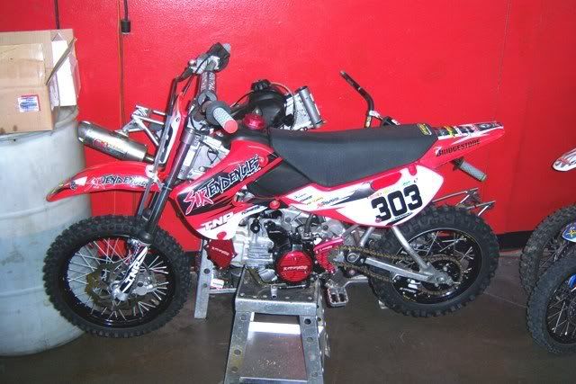

I just did the following, tell me what you guys think of my newest build:
MOTOR:
Suspension:
Misc:
here is some pics of the bike:
I just added this pic in a later post but thought I would move it to the first post to show the red oil line:
MOTOR:
- 150 kit with stock cylinder
- 4th gear shift drum
- HD output shaft
- Billet shift star
- Brand new 2nd gear
- Red oil line
- Takagawa Hyper Cam
- Main, Pilot and needle/rejetting stock carb (Thing freakin rips)
Suspension:
- HD mild springs in the forks
- Fox Float shock
Misc:
- Brand new Red Plastics with STR Graphics
- Renthal Bars
- Pillow Grips
- Two Brothers Triple clamp
- Two Brothers Tall seat
- Two Brothers Red Big Nutz Kit
- Two Brothers Red Over the top brake pedal
- Black Excel rear rim with black powder coated stock hub and heavy duty spokes
- Big Minis Drum brake Torque arm remover
- Welded tab on swingarm to hold big minis eliminator kit for the rear brake
- Front Disc brake adapter for stock forks
- Marzocchi front 14" wheel
- CR85 front disc brake
- STR/Galfer wave rotor for Marzocchi wheel
- Two Brothers M-6 ss pipe
- P2 tip for M-6 pipe (Silencer)
- Two Brothers Footpeg mount and Fastway pegs
