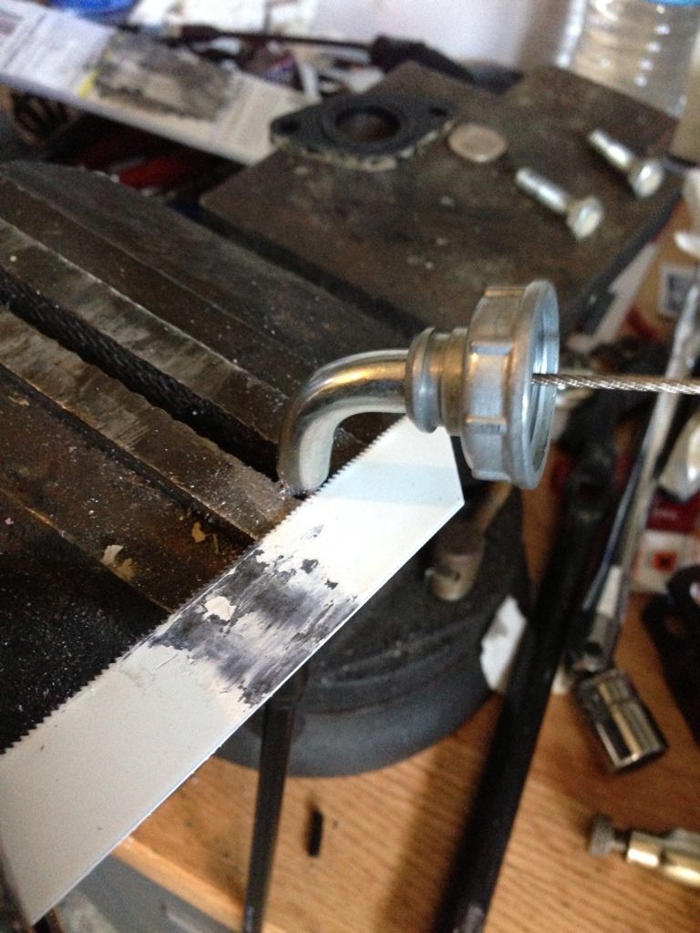

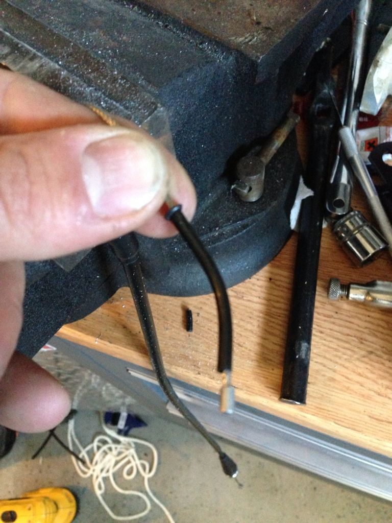

I wanted to use the stock cable if I could (I know, I'll need a longer one anyway when I mount up my zocchi's) lightly held cable in vise and cut off the crimped end.

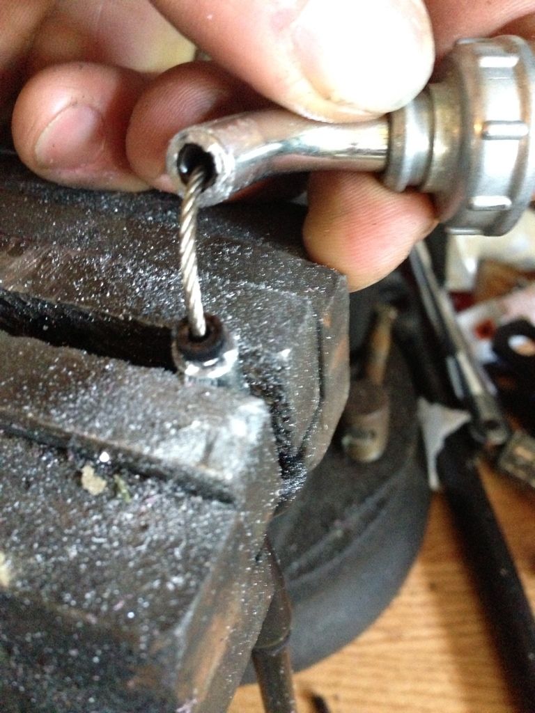

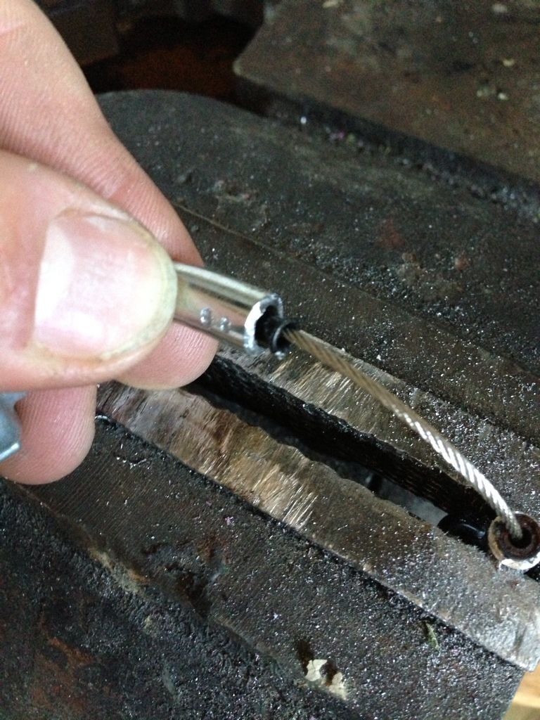

Once that is off, and Hopfully you didn't hog up the rubber/plastic sleave in the elbow. Ill reuse this in the larger carb cap.
Carefully pull the sleeve out of the stock elbow. If you pull too hard, and a small burr catches it, it will ball up and it will stay like that.

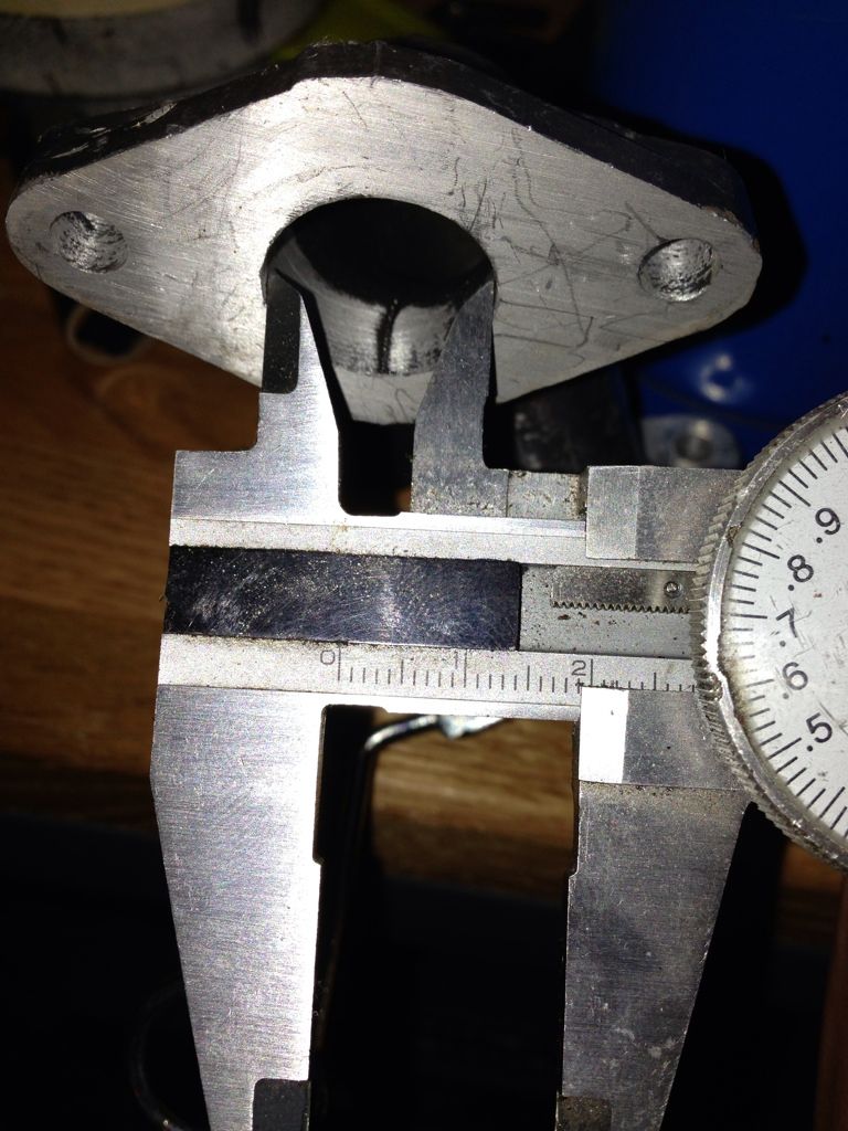

I got a different 20mm intake, but I noticed the stock intake looked bigger then expected... So I measured it, and its all but 20mm... So I decided to just use the stock intake.
