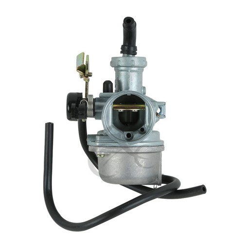

Mikuni 22mm works well on these bikes as well.
Wholesale cycle has the emissions block of plate for the cylinder head port and they have tested and tuned numerous skyteam 125cc bikes to run the 22mm with oem air filter as well as UNI pod, with only a few adjustments to the air/fuel setting

All those carbs look cheap, kinda like what's on my bike already anything better?
I don't think it will really matter to me on running a cable operated choke.
It does make it easier to choke but I want it to run better more than anything.

Best move is to take that stock carb off and use it to keep cats and raccoons out of your trash cans at night!
It track down a genuine mikuni VM24 and tune that in, everything posted or suggested so far is just a different casting of what you already have.
Or you can de-tune a VM26 way down, I had a pe28mm on my skyteam ct (it was a stroked 146 though) it had a small gargle when taming off from stop lights but I'm pretty fat, but once you go up to speed the 28 would pull for a loooonnngggg way!
Good luck with your machine!
#14 ·
Buckit your right, all those carbs look like the same thing as what I have or close to it.
Maybe one or the other may be better than the one I have if its adjustable with jets or needle.
I may have another carb similar or bigger that I can maybe mess with. I need to find em in my parts bin....
But with my luck, something won't work right.
Will my cable work with most carbs or is it a pos cable only for this carb?
I may have a vm24 carb but idk if the intake, cable etc.. will work with the carb.
id buy a vm26 but almost $200 is outa my range at the moment until I sell some stuff.

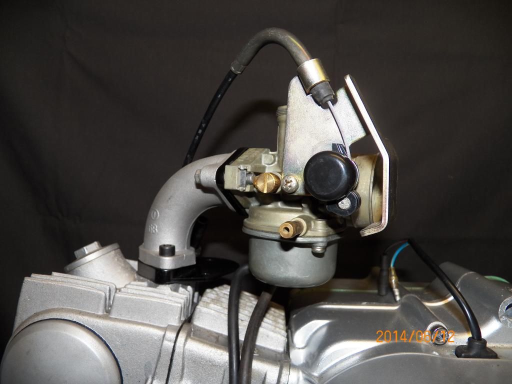

If you do make the swap over to the VM, you will need another throttle cable, the one that comes on those bikes in stuck to the carb cap like on CRF50's
The cable you need can be found for $17 from Wholesale cycle(#1049) & other vendors as well
The stock intake will accept a rubber spigot for the VM's but I opted to go with a TB stubby intake for the wider port diameter. Better get out to the garage and get to digging in that box!
