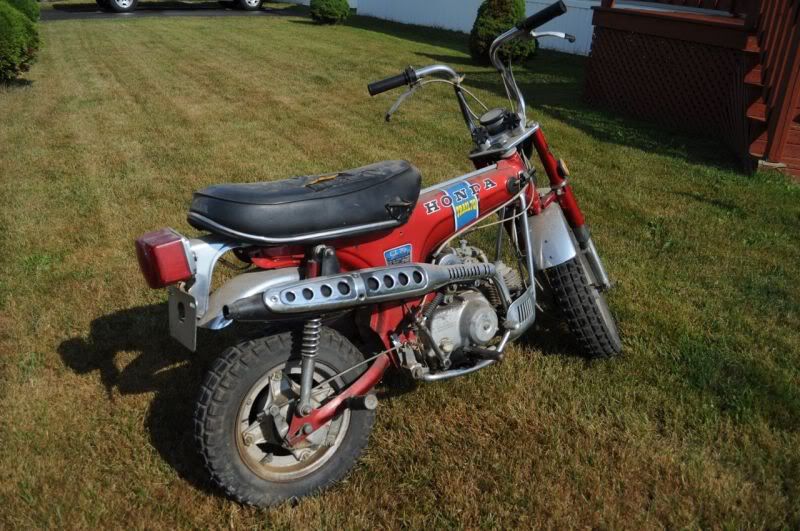

Hey everyone,
I sorted out the carburator and went for a short drive yesterday.
Couldn't stop laughing, 40km/h feels like 100km/h on this thing!
Here's few pics. I still need to order a seat and fix the wiring (headlight doesn't work)
Someday I'll polish the brake covers; I put them together to make more room in the shed.

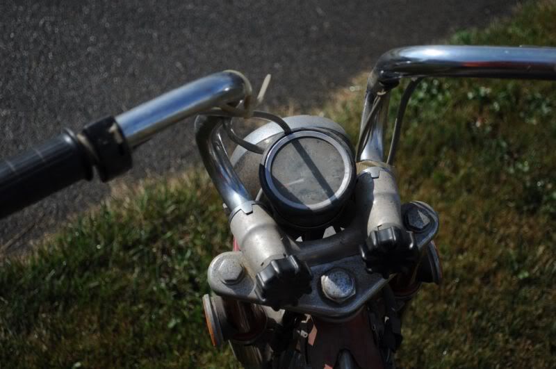

Discussion starter · #100 · (Edited)
I put most of my parts on:
Things to do:
- Fix high beam indicator light in speedometer
- Paint Engine Cases
- Finish front hub (install wheel properly)
- Install new wire cover (non-shrink)
- Install mirrors
These are universal mirrors I purchased. I really like the size and look, but the stem is bigger than the screw holding the levers. Should I just drill them bigger? or is there a better way of mounting them?
