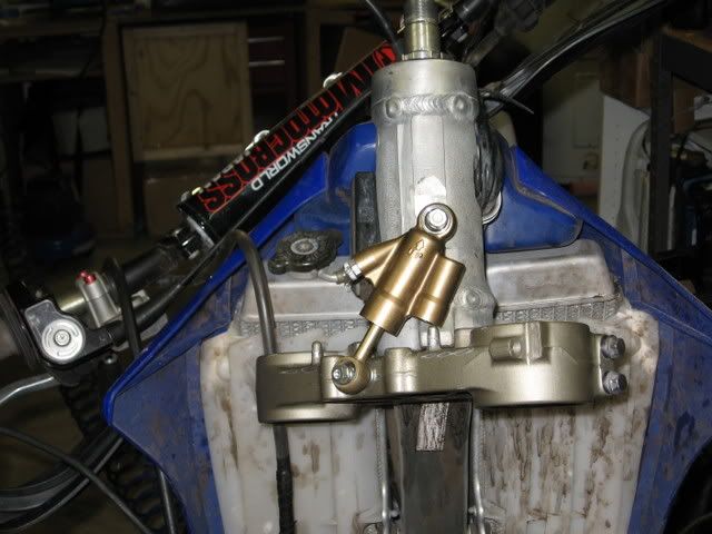

For those into big bikes, most know the new honda crf's come with a tiny steering damper stock. Everyone (except Josh Grant, he says he cant whip or turn with it on the bike) Loves them and would never trade them for anything. I was able to get one of the dampers that was practically brand spankin' new! Heres my little write up from TT.
I just got a factory Honda steering damper from a friend off of an 08 crf250. I got it mounted on my yama-pinger tonight. I havent heard anything bad about the damper from anyone but Josh Grant (he hates them and says he cant turn the bike or whip it over jumps). It seems every one loves them no matter what type of riding.
I have one question for the people with crf250's. Where the do you run the clicker at on it? Just looking for a starting point.

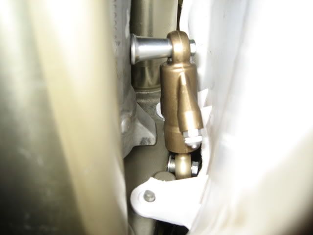

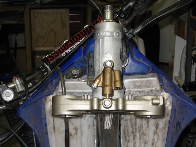

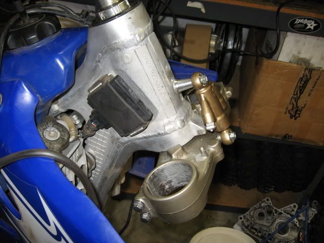

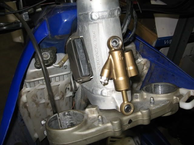

here are some pics of the mount job...
No, it doesnt hit the little tangs the # plate mount to...

I just tapped the steering tube (its about 8mm thick... hope thats enough:confused:) and triple c.
I had to get the right hight of the top hole... I have an extra hole I have to plug eekkk... and make sure it was spaced right.
I will for sure let ya'll know how she works :):):):):)
and I have no idea on the price of a new one... mine was a freebie! :)

I dont have any experience with dampers on MX bikes, but the Scotts damper on my R6 worked wonders on some of the choppy commuter roads around here in addition to keeping the front end tight under hard acceleration ("floating"). If you decide to keep it, I would strongly suggest you getting those mounts welded in place, maybe even add a small horizontal gusset on the head tube mount.
