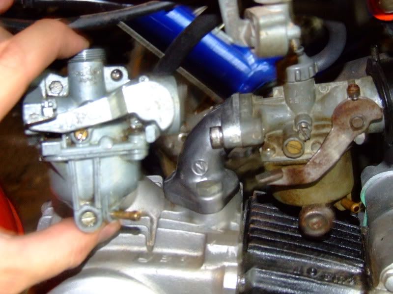

Well it just didn't make sense to me that after I started messing with the carb the bike pretty much stopped running. On the first night I had it I was able to get it started and ride up and down the street...so I suspect it was still the carb.
I got a couple of other motors and a spare Z50 parts bike. I stripped the carb off that bike which was different from the one on my bike, took it apart, cleaned it out and put it on. I tinkered for a while and got it running....and actually got it to rev....hmm....
Click it into gear and I'm gone, up and down the road, no backfires...so its gotta be the carb. Now, I looked at the schematic of the carb I took off and it exact matches the Z50R.....so I'm wondering why this other carb works better.
Anyway, I do have another question. In this pic of the carb that was on the bike when it was not running you can see the brass tube I'm pointing at which I assumed was a jet. I tried to run a very very thin copper wire in there and it won't go more than 3cm down. Is this passage supposed to be open or do I have a major clog?
Here are the two carbs side by side. The one in my hand is the non-running carb...which I think may actually be the correct carb.
You can get a CRF50 carb for $10-$20 in the classifieds. It will bolt up and run for another 30 years. Just make sure you get one off of a 2005 or older so you have the adjustable needle and air screw.
As for which carb is correct, the 1984 Z50R has a very similar carb to the one in your hand. The one on the bike is off of an older Z50. Either a hardtail or early softtail.
Early softtail. Hardtail carb was more square-looking in the bowl; had different "guillotine"-style choke instead of butterfly.
I'd say if the bike runs well with the second carb, your work there is done. Take the shiny carb apart at your leisure and figure out where the blockage is. I don't have a Z50R carb here to look at, but from the vid and posts it sure sounds to me like there's a blockage in there somewhere and the bike's running lean enough to have poor throttle response and make little popping backfires occasionally.
As mentioned above, dirty, pitted or incorrectly gapped points can sometimes do this too, although when they do you'll usually get a dry, sooty black spark plug from the weak spark/incomplete combustion. These symptoms, when they come from lean mixture, instead should give you a real clean whitish plug from overheating the plug.
In any case it sounds like your problem isn't points this time. But don't be afraid of the points. Get yourself a flywheel puller and swing by a NAPA store and get yourself a points file, and a good feeler gauge. And a can of electronics cleaner. File 'em flat if needed, clean them with the spray cleaner, set gap to .012"-.016". (You have to set the gap with the flywheel installed, because the points cam is part of the flywheel, but it's easier to file them with the flywheel off).
More than 90% of the time that's all you need to know about older Z50 ignition systems. It's an easy process and diagnosis gets easy once you've done it a few times.
Cool bike; high-five yourself a little bit.
