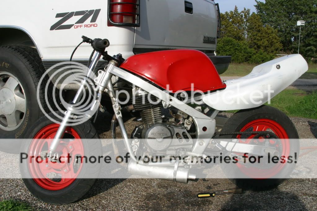

My 87 ysr ex-racer, cant afford to race it, so might as well toss out the 50cc 2-stroke and bolt in an xr80, its currently rideable, but working out some kinks.
(it looks ugly i know) but i got a nice bodykit for it that i dont want to trash.
working on adding a few more things, i'll keep yall updated.

the pipe is just what i could make by hacking up the stock xr80 header and crapply welding it together, and adding a silencer off my old ysr race pipe. i'm gonna see if i can secure it a little better but for now it works. I would love to get one made for it one day thats properly done.
and for the looks, here is what is what it looks like with the kit on it.
and with the 50 motor and pipe it would top out at 70(while still running a massive 48t on the rear), stockers hit 45, but this pipe was imported from japan, and are worth a ton and are hard to find, unfortunately, mine got crunched up like a soda can after the rear shock snapped in half during a turn.

alright, tonight i redid the pipe, made it a little more stable, and where its more protected under the frame, either side the bike goes down on, the pipe should be fine.
also rigged up a rear hand brake, and i can still use the foot brake, i havent ridden it yet, but tomorrow i'll put the bike though its paces, just gotta put the sliders and seat back on it.
i'll get some better pictures tomorrow out in the daylight.

here is a youtube video of it up and running, but its torn back down right now to work out some other problems i'm having. sadly, no stunt pictures or video yet.
no, it would be pretty easy, but would require me to either chop up the stock clip ons, or buy an $80 aftermarket allum top clap. (the stock top clamp does not actually clamp to the forks at all) I have everything to do it right now, but i'm just afraid of hacking up the stock clip ons.

alright, uhm, i ordered a 12t front sprocket, going from a 16/48 to a 12/48 -4 in the front translates to about a 16/55 ish(i think), so anyway, it will give alot better lower grunt ( i really want to be able to bring the front up with out clutching it, i'm not sure if thats possible or not) but according to some sprocket calcs, it will be topping out at a whopping 25-30mph.
also working on trading a stock ysr part for a SS brake line
and i may just jack the risers and steal a bar from a mountain bike, its much flatter than the dirtbike bars i have now, I may just try that out and see how it goes.

yeah, carb will be in monday, so hopefully i can finally get this thing up and stunting, its killing me to sit and look at it and not beable to ride it.
and the best part is with the motor swap, if i ever find an xr100 motor cheap, its a direct bolt in with the mounts i already made, just pull out 2 bolts, swap it in, swap a sprocket and ready to roll out.
