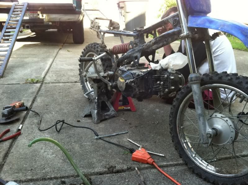

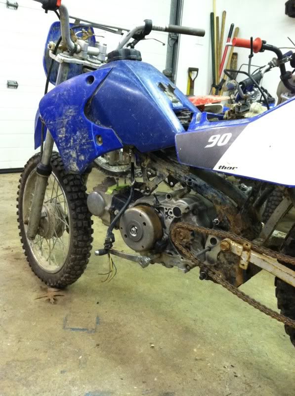

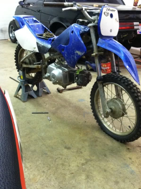

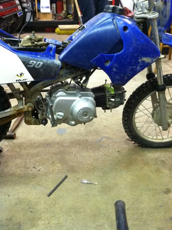

Well I thought I would share what we are doing to my friends 90.
After I bought a 140 for my CRF70, he decided he wanted one. I told him it wont bolt up.
So after a little looking and thinking and holding my 70 motor up to the frame, this is what we came up with.......

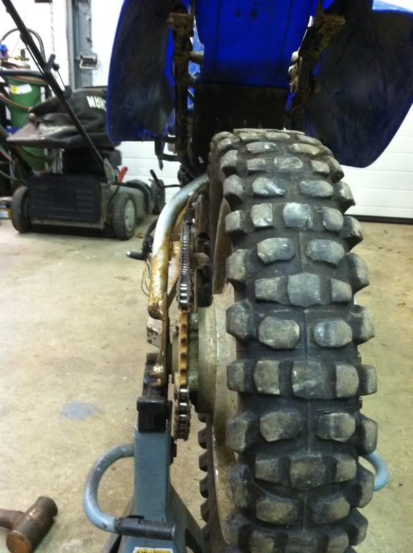

Even the chain tracks straight
Upper mounts are being made as we speak.
Since most crate motors come with everything you need to make the bike run, ie: electronics, intake, carb, kicker, shifter, all the wiring on the TTR can be ditched for the wiring in the kit. All you need to get is a longer throttle cable and a straight intake tube and a slightly longer chain, about 3-5 extra links. Most kits come with an angled one. The carb is tall so it will fit just under the tank in between the 2 down tubes of the frame with plenty of clearance. (As far as we have measured)
Post your comments on what you see.
Thanx for looking

Well hopefully we will have 2 here running Honda based motors. once we get the brackets finished up and welded then we are gonna stick my old 70 motor in it and get it fired up to check how it will perform.

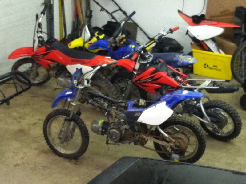

The TTR in the back is what the 140 motor will be going in and the TTR in the front is the donor for mock up. That way the other one can still be ridden.

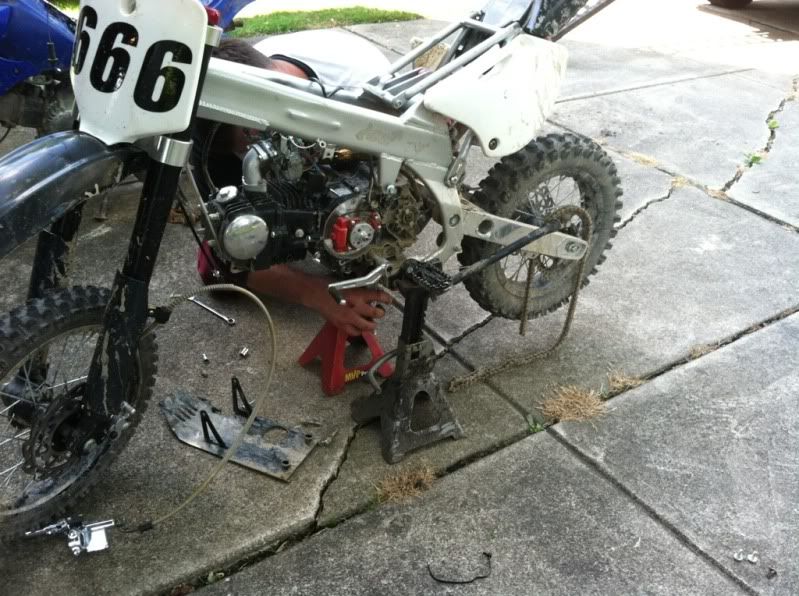

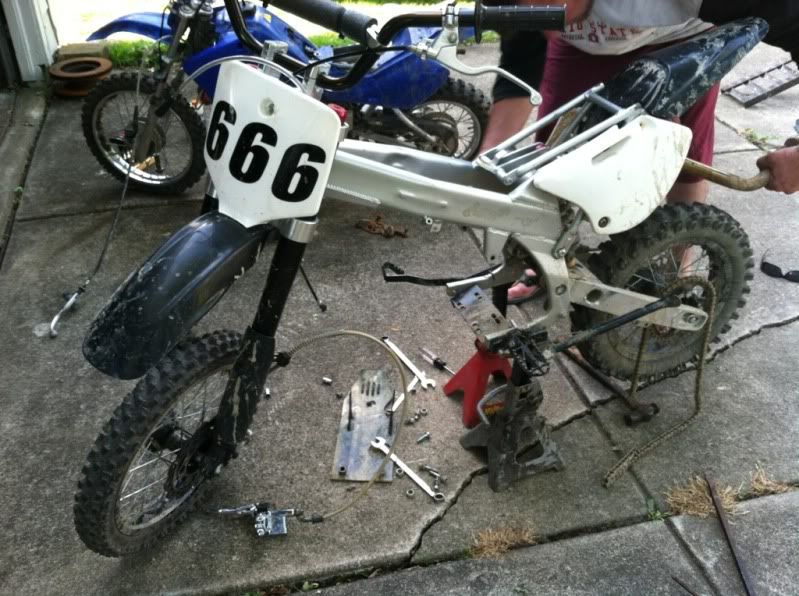

Update:

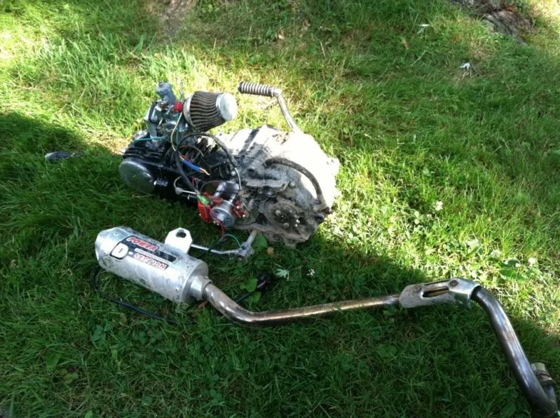

Its finally moving along. He got a free bike from a friend of ours, junk Coolster 125. The Lifan 125 motor is a good runner with a inner rotor kit. So we stripped it down and started mocking it up.
He will be re making the mounting plates because this motor is much larger than my crf70 motor.
#29 ·
Thats what I plan on doing. Use the rear mounts to attatch a bracket and cut/reweld the top one.
You have aftermarket forks though, that's probably why there is so much room BUT it also looks like you've angled the motor a little bit more than the OP which is what I'll do as well.
