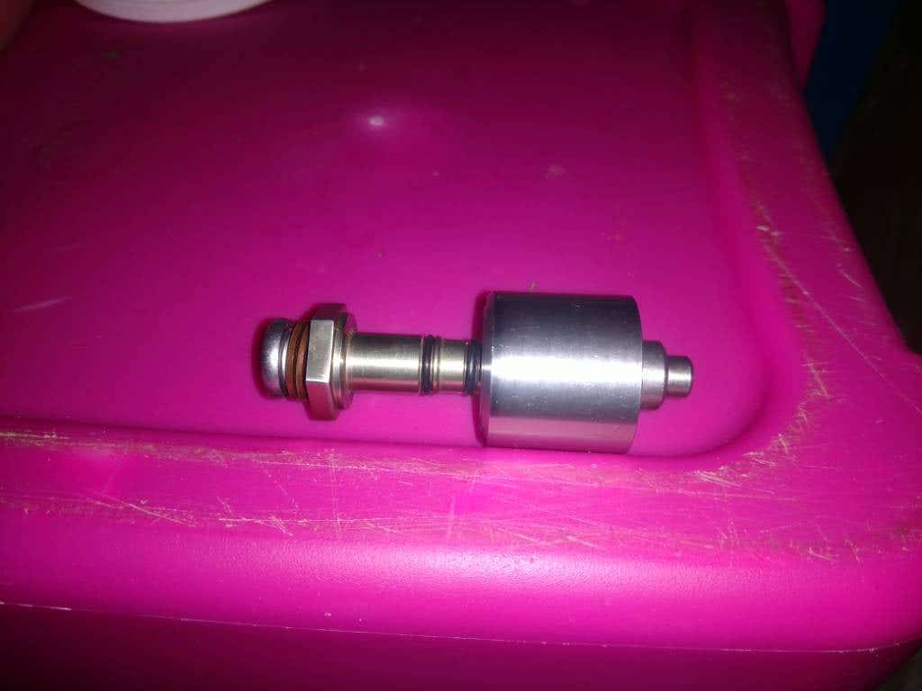

I think this is called a slave cylinder..?
I was told I could make these parts work with a stock TRX90 clutch. It's definitely not a direct fit. I think it must be made for a different engine. I have searched, but couldn't find one that looked quite the same.
Does anyone recognize it, and can give me any info about it?
Pics on the way...
#5 ·
I think I measured the throw to be about 6mm. It does fit in there, with room to spare. It would need a bushing to fit properly in the bearing...and to make up about 10mm to fit tight against the clutch. I'm sure it could be made to work, but I figure I'd need at least 3 custom pieces turned, and then it will still stick out a little too far on the outside of the motor.
#6 ·
I was intrigued with the concept of a hydraulic clutch actuator yrs ago but every one I have seen stick out from the engine case enough to be a problem for me.
