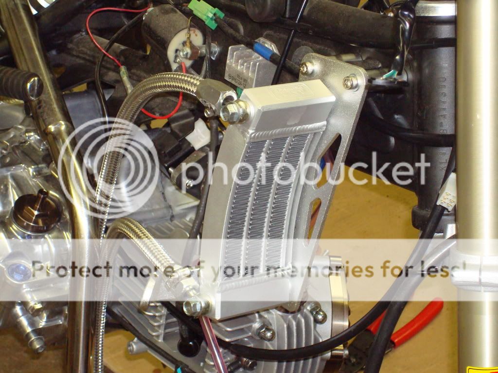

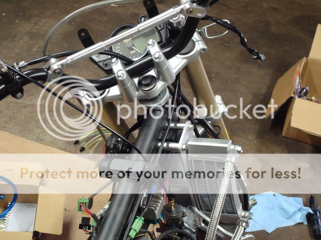

I have a Two Brothers run off the filter adapter now. I could add the right side SGR and run it in place of the existing head-to-lower line. And then add another one, run off of my Takegawa clutch cover, for just the oil in the bottom end. The singe Two Brothers works great for me, I got lucky and got a deal on it here on PM.

i got the TB kit a few weeks ago and havnt been able to try it out yet because the bike still doesnt have a carb lol.
but from the looks of it i think its a sweet setup, the only downer is that i couldnt use my Asia Works piece because the bolts were bigger diameter than the oil dripper bolts, so they wont fit the TB hose ends(or fittings, whatever you call them).. :(
so i think im going to run it in place of the dripper like TB intended and maybe later get different hoses made to work with that piece..
