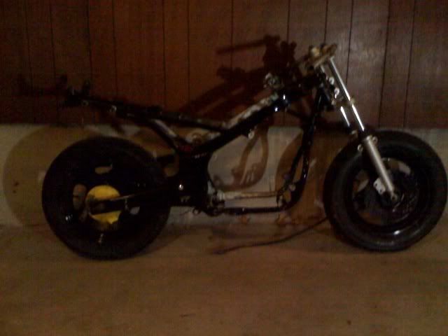

Well i bought a 89YSR50 four weeks ago for $400 delivered with title. I was looking for that exactly (rolling frame) Didn't run. broken fuel petcock. No plastics. Dented gas tank (custom sweet paint). Someone tried to paint the frame and wheels black. 60cc kit. pretty stock. So far i took the motor out with in the first 10 min. 30min later the bike was stripped. I did alot of research before i bought the bike, so i knew what i was going to run into, broken ignition switch, shock/swing arm bushing worn out, rusted tank, $hity 6VOLT!!!! (AHHHH!!!), ECT.....
So now I'm about to install my 86 XR200 motor (I just did a fresh rebuild AND 12VOLT! YEAH!). Fit it and then get the frame powder coated. Hopefully done in the next week.
Fixed the huge dent in the tank and tomorrow ill (KREEM) it. Ordered a bunch of parts. (fix it crap, bearings/bushings/right spring/seals).
Heres a few pics. Just getting started. more to come soon. Ill keep you posted.
By the way all of the pics are taken with my phone, Sorry...
When i got it.
30min later!
