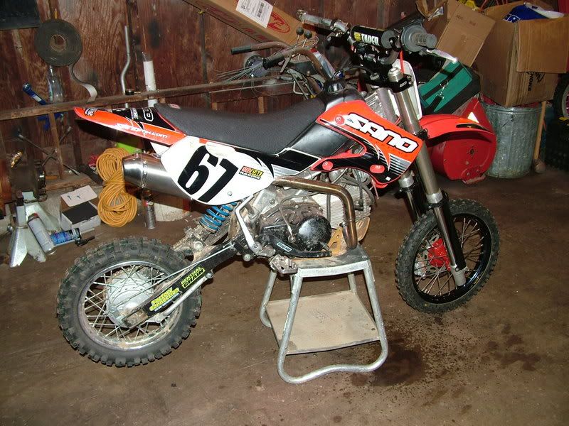

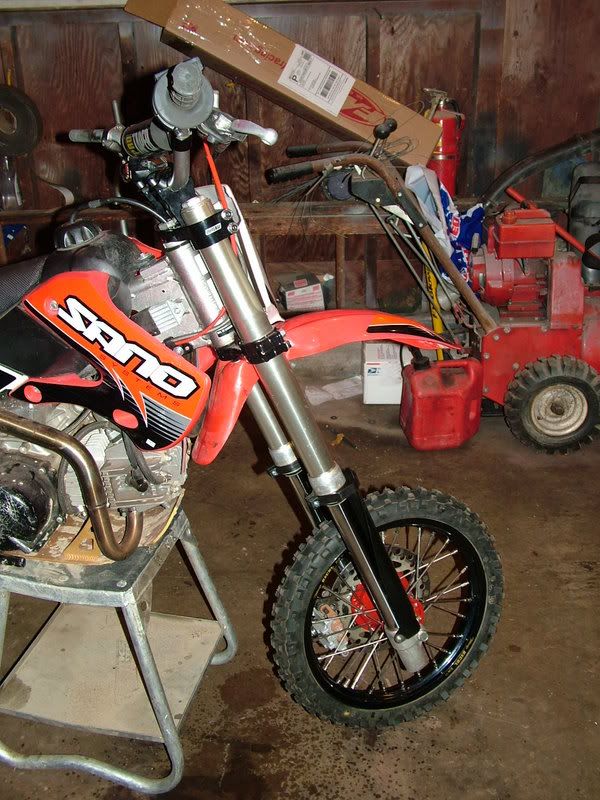

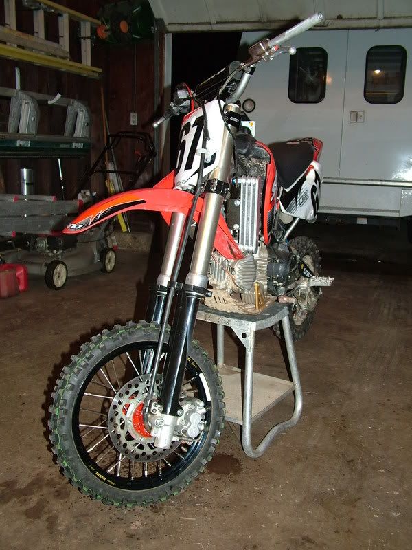

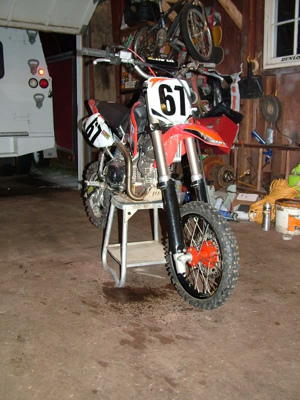

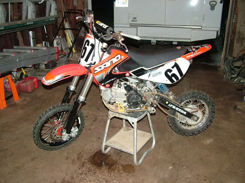

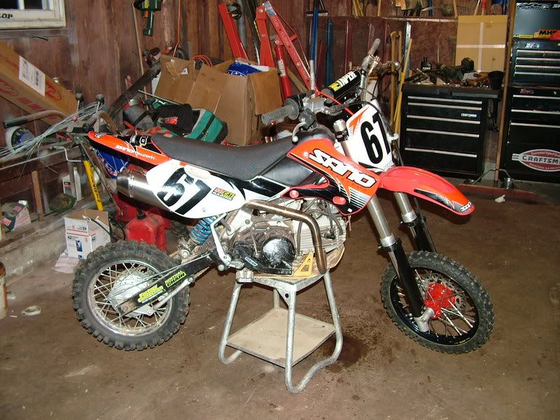

Kx 85 forks...Done
1 reading
11K views 26 replies 13 participants last post by  zbra09
:grin: Heres the pics
I still need to get them shortened. 2" will do it abut right:grin:

#13 ·
Str8Ryder76 said:
How much would it cost to have them shortened 2" ? I have access to a pair of these forks, What did you have to do to get these on the 110 ???
You need the clamps, and 2 sets of tapered bearings for the klx110. You use both upper bearings/ races. you might need to take some sand paper and sand the stem just a lil down bottom but the bearing will go on. Thats it... slide it together and ride away...
As for shortening them...im not sure how much it costs...
Also you need an 85 hub, brakes and 65 wheel.
klx fender will fit on, so will the number plate with a lil modification, or you can use an 85 number plate...an 85 fender would look goofy...
#15 ·

The clamps being kx85 triple clamps ? Use both klx110 bearings on the top of stem ? or 2 top and 2 bottom ?
Kx 85 clamps, yes. I went aftermarket top clamp. You use 1 top bearing from each kit. The bearing diameter is the same on the kx85 (top and bottom) and the klx is not. Thats whys you need two top bearings.

#19 ·
Looks nice.
So you lace up the 85 hub to a 65 rim so you get the 65 wheel size but 85 brakes. Did you use 65 spokes to do that also?
Does not look bad at all but I would like to see a picture of the bike on the ground. It seems level when on the stand.
I got the sano mx swingarm kit so it should not be too bad.
I think I may go with this in the spring.
#22 ·
USERNAME said:
Looks nice.
65 rim and spokes... I will need to get the fork shortened but when i do it'll sit perfect with any swinger (bbr-sano-etc) This is from comparisons of my bike next to others.
Yup, 85 brakes:grin:
Its not that cheap, but its top of the line for sure. Considering you could buy a cheap 85 (the whole bike) for what you can buy zokes for you could part the rest and come out alot farther ahead.
I bought alot of the part separate so it cost more, then again most of my stuff is new or after market (black fork sliders, excel rim, triple clamps, etc...)
Cr forks would work better cause you can slide then farther up in the clamps (the forks arent tapered like the kx's) but im not sure if they'd fit in the clamps or not...
