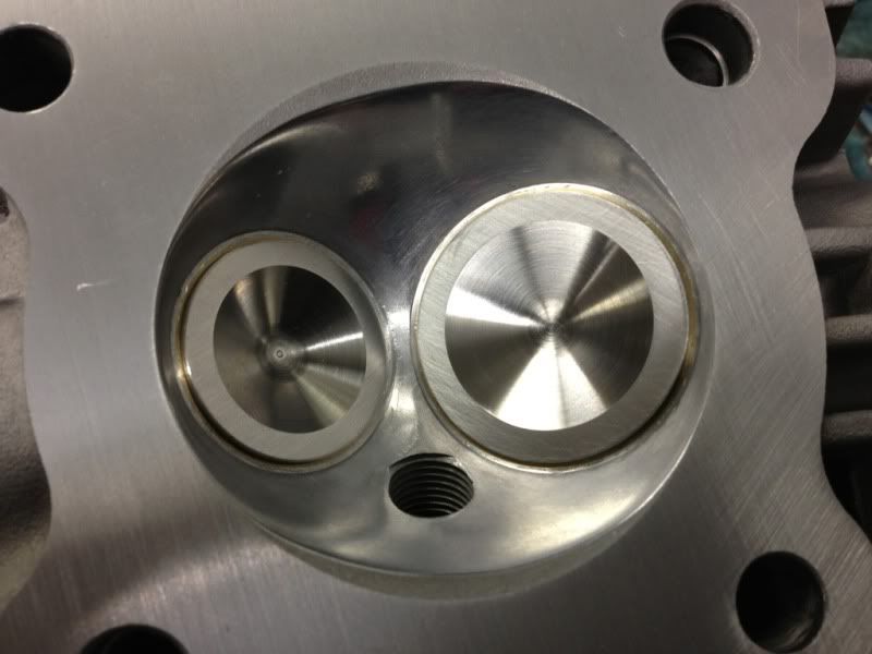

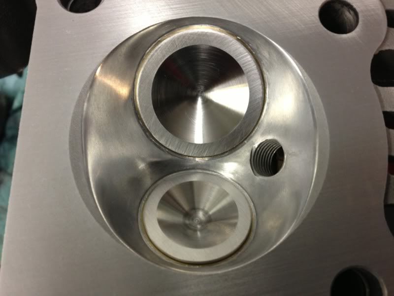

#8 · (Edited)
Already has bigger valves and ports than the stock head. Bolts on like the stock head. Check the piston to valve clearance. Picture shows what correct piston should look like. Most 143cc kits come with the correct piston. There are 3 different intake manifolds that can use the VM26. One for the stock head, one for the race head w/25mm intake port, and V2 heads w/27mm intake port.
