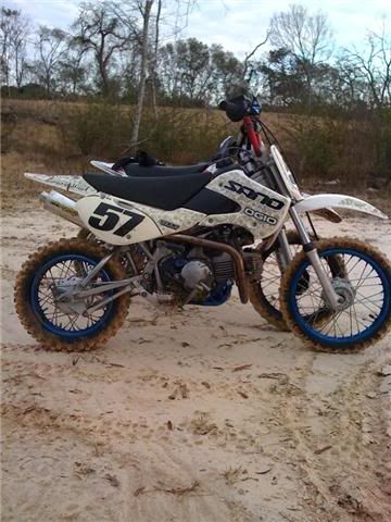

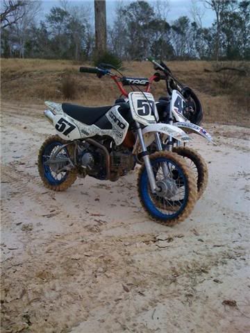

did spray paint(anodized color) looks great i think. goes with my dress up kit! what do yall think?

I've used it on apps for automotive. Holds up fairly well, scuffing a black or cast surface with a scotchbrite pad before spraying creates a marbelized look. If you don't scuff it to a shine or use their primer that is.
#11 ·
Metalcast spray paint color of ur choice 7.00 from autozone. It's made for a chrome like surface which my stock klx wheels were. If it's alloy color u have to buy primer. Took fine sand paper an went to town then used alcohol to clean them off. Taped off the tire an around the spokes and started to paint. I did it blk on my old 250f an held ip good. I'll add some more pics tonight when I get off.
#16 ·
Yes I did it with the wheel fully assembled with the tire on. Just go buy a 12 pack an be creative. I just taped off everything. And yes later I will post up alot more pics.
