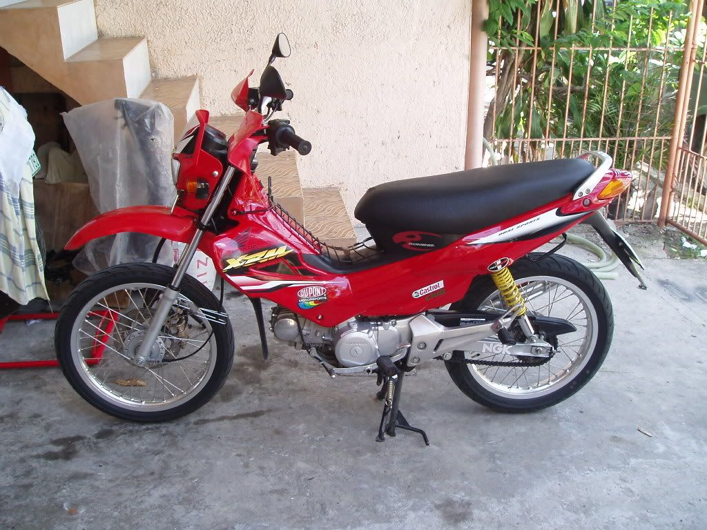

those are 4 speed auto engines from thailand dave :) :cool: the honda xrm is available only here in the philippines. it's it's a honda nice with different front fender, headlight, and handlebar ;)
here's my favorites ;)
