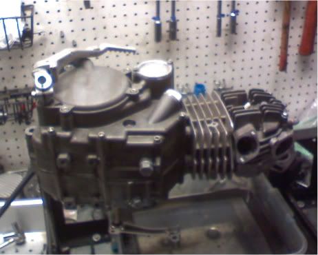

Here is garn627s Daytona,, felt it was a little weak so he wanted a little matified FRD power added. turned out pretty good, this is the video right as we finished up .
Custom crank (not off the shelf)with +4mm rod length, custom fullskirt piston (superlight),custom cylinder.
BBR Daytona cam, Garns own porting, FRD manual cam chain tensioner. 6 disc clutch (needed it for sure).
This crazy engine fired up on the first kick!!
Click on the bottom pic for video.

Thanks again Matt! This motor rips! It's way smooth, tons of bottom end and revs to the moon! Good combo!
We'll see how much more HP the DOHC gives it in a few weeks when it shows up! I'm going to run the stock head for practice and run the DOHC when I race!

chrisc161076 said:
Good build, what's the $$$$ to build up that engine, did you have to do any internal mods?
Any plans on going bigger or is that the max?
when you say internal mods??
to the castings,, :rolleyes:
But a completly different crank, (not the sort rod "160" crank)
Different cylinder, piston, timing chain, chain adjuster and tensioner.
Aftermarket cam, 6 disc clutch, HO style oil filter.
Have not pinned down a cost yet.

what things did you have to do to get the 4mm stroke in?
i have a 2mm offset pin in mine at the moment making it 160cc.
i had to
make a big base plate for the barrel.
put a longer cam chain in.
re-weld the cam chain tensioner
and shave down the copper head washer to give some more stud thread.
and what compression are you running with the 171cc setup?
