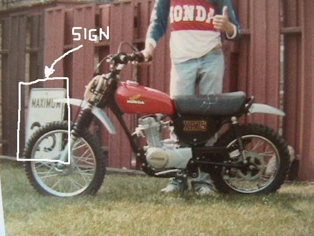

reynolds_brad said:
Im still getting used KPH on my monkey as the LCD speedo im running is in KM.
This is an old pic of my 1976 Honda XR75. If you look by the front wheel you will see a max speed sign in the background, the sign is in MPH. Way back, Canada went by Imperial measurements then later changed over to the metric system. Guessing 1979?
