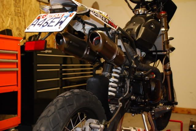

+1 with matified... he knows his stuff and has built some dope exhausts...
I always like how that one sounded, I put the second at an angle and made a diverter internally to direct equal amounts of exhaust to both tips!
