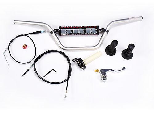

We have this kit in stock
[h=1]BBR Handlebar Kit - Tall Bars w/Controls CRF110F
[510-HCF-1101][/h]
A must have for larger riders on the CRF110F. Replace the stock "low-rise" steel handlebar with BBR's Premium Aluminum MX bar. BBR bars are about 2" taller and 4" wider with considerably less pullback to provide a much more upright and aggressive riding position. The BBR throttle, cable, and carb top allow you to run normal sized motorcycle grips.
Complete kit includes BBR aluminum bars, extended throttle cable, machined carb top, throttle assembly, extended front brake cable, shorty style brake lever, grips and BBR bar pad.
• Aggressive riding position
• BBR Aluminum MX handlebars
• Throttle with extended cable and carb top
• Shorty style brake lever with extended cable
• BBR grips and bar pad
