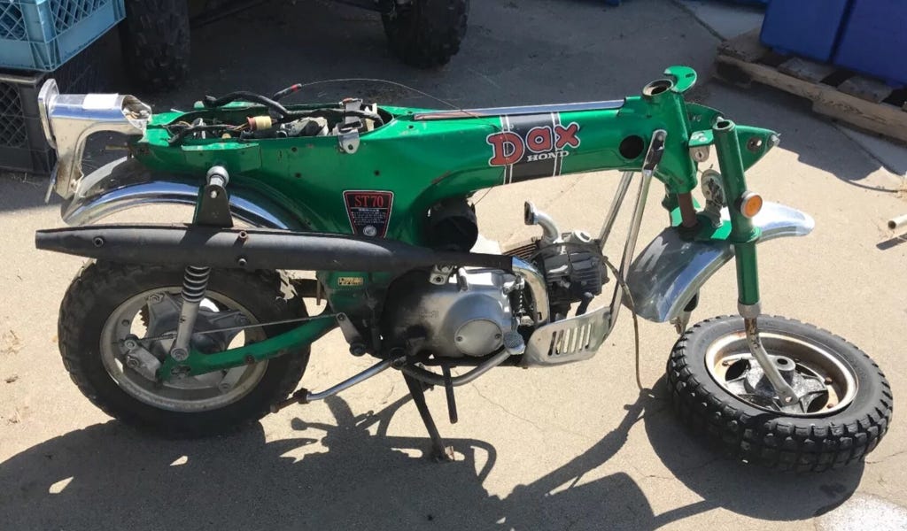

The project came to a screaming halt today. I received the bike and the frame is buckled and twisted. I should have known from the pictures but hoped it was from bad camera angles.
Since many of the parts are Dax specific, I'm unsure of my next step. The bike was oddly free of rust and the motor turns easily. Perhaps a Dax tribute?

On a positive note, the motor turns over. I installed a new plug, new kick starter, bolted the carb back on (was lying in the frame), poured gas in the inlet and it started right up with about ten minutes of work. Idles and revs great after sitting for at least 20 years.
