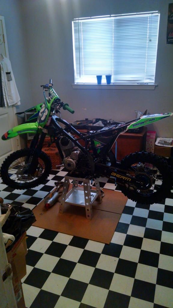

I meant to make a thread when I first built this bike, but ended up forgetting to, so I figured I'd make a thread on the rebuild of it! Haha
Anyway, here's a few details on the bike.
Suspension: RM85 forks, and shock, setup by MotoMods.
Motor: Bore kit, with head work done by StorminNorman, and BBR's 26mm carb kit.
Misc: Custom made triple clamps by Topar Racing, FMF powercore 4, with powerbomb header, KX85 front number plate, restyled KX85 front fender, and a shit ton of powder coating.
Here's how the bike started out
Literally the day after I got done building it.
At it's peak.
How it sat Monday just before the tear down began.
Tear down begins
Got the motor out. The first time I did this, it was a PITA! but I had it out 15 minutes after the last pic was taken.
Then tore the motor down, so I could send some stuff off to Stormin the next day.
Now today, I started taking the roller apart, so I can get my suspension rebuilt, swap out frames, and do some other stuff.
And now, as it sits.
The plan for it is some more motor work, 28 carb, rebuild the suspension, frame swap [modded this frame to run CRF pegs, like DoPayToPlay did, but not a fan of them anymore], re-doing some PC, and fresh graphics. I'm hoping to have it back together by the end of August, so I have time to test everything out, before the Stillwater Mini-X series starts. I'll be sure to update this thread as it progresses! :cool:

Looks fantastic. I see that you went with the 14/17 inch wheels on the rebuild. What's it take to get that RM85 shock to work? Did it clear the frame? --L*64
Thanks! Yeah, I'm not a fan of the big wheels. The small wheels make it feel more like a pitbike to me, although I wish I had the extra ground clearance the big wheels give you. Just took a little cutting and grinding on the top mount to make the RM shock work. It cleared the frame about the same as the KX85 shock.

The RaceTech setup would HAVE to be in the $500-$700 range I'd imagine. If you spent $100 on a used 85 shock, then another hunnert for the correct spring, add another two hunnert for a rebuild and revalve, and you're at $400. It still will have too much travel for the available ground clearance IMO. I'd rather spend a few hunnert more and get it perfect w/o any mounting drama. It's just how I think I guess.
Awhile ago I was thinking about morphing a KLX140L rear shock, and a KX85 shock. I was thinking about cutting the body somewhat shorter n the 140 shock, and machining the lip so it would be the same as stock, only shorter. Then I was thinking about slightly shortening the shaft of a KX85 shock, and running that in the 140 body. That would be a stock 140 shock that would yield 9.75 inches of travel, and fit like it belongs there. Then I was going to slightly mod the stock linkage to achieve the correct ride height, w/o comprimising the stock leverage ratio of the linkage. I had also thought about reconfiguring the entire rear end to accept a KX85 or 100 rear swinger and linkage. THAT would be a sweet project!
I may get around to working with a 140 someday, but the 150F is alot less work if you could imagine. I like the 140 alot though, and it's got quite a few things going for it including the rear disc brake, and the ability to run the 14/17 inch wheels. Next you gotta figure out how to get the Thai kickstarter on it. --L*64

Damn, that's not too bad. I'm right there with you, I'd pay a couple $100 more to have something that's perfect for it, and bolts up with no modding or any problems. If I didn't already have my stuff all done, I would have considered going with a custom built shock instead.
I've tried looking up the parts for the kickstarter, but I can't seem to find anything. I like the E-start, and wouldn't get rid of it, but having the kicker as a backup would be nice. We went up to Stillwater once for a race, and when we got there, the battery on my buddy's [Blake] bike was dead. Bump starting it the whole night, and the next day was a PITA!
BTW, here's a little update. Did some cutting on the frame. Still got a little more to do, but my back decided it had enough, and kept me on my ass today.
Also cut off where the kick stand mounts, and where the stock linkage shifter mounts [I run a modded KLX110 shifter to get rid of the linkage]
For comparison
Easy 10lbs right there! Lol
