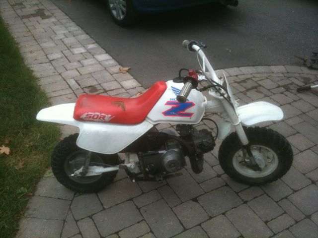

Thought i'd put up some pictures some of my mini toys - 1982 - 1979 - 1976 - missing is my 1981

I like the extended tailpipe you added to that FMF muffler on the Z. Getting the exhaust out from under the bodywork and off the right shock reservoir seems like a very good idea to me.

The Z was a fun project and i've put some good trail time on it since built. The FMF muffler is actually a cut down piece from a honda CR500 that i had laying around, so combined with a cheapo pitbike exhaust header i was able to make it sit how i wanted it to, but did not want the exhaust blowing on the shock or the number plate - the tailpipe was quite a little challenger, i had to pie cut and bend and reweld multiple times to make it snake around the shock and still exit straight out the back (exit is actually almost dead on to the location of the stock muffler)
the swingarm was cut and machined plugs were made to stretch it 2inches then welded and blended to dissappear, the fork lowers are brand-x minis chomoly tubes with HD springs and delrin bushings, and it is a lifan 125 4 speed,
The stock bodywork was trashed and had been painted etc.... I couldn't justify the cost of OEM plastics, so when i found the XR50 plastic had the one piece rear fender and number plate i thought it was worth a shot, it is ACERBIS limited edition silver plastics, with some trimming and some heat gun it worked and i think it looks pretty damn good and seems like it belongs there.
