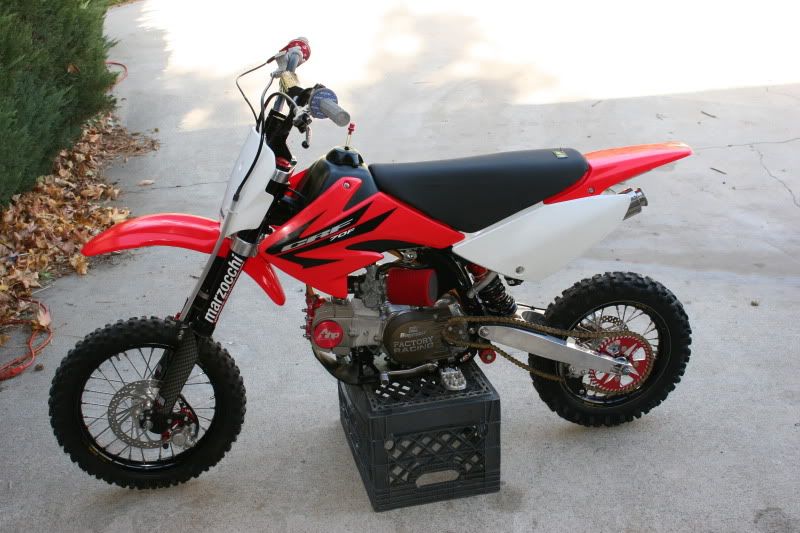

there it is sports fans...
Discussion starter · #35 ·
Threw a new spring one it and messed with the idle some still idling high..
took for a ride on my track and it pulls purty dang good i must say!
little more carb and shock tuning and it ill be golden.
The photos are a starting point? I have to say that bike is so sick already. I love when minis look like full-size bikes.
Your mention of Reeg made me check their site out since I haven't been there in a while and only now am I finding out they're basically out of business, except for selling a limited supply of replacement parts. That's very sad!
I did not know they went out of business. I got a whole reeg gp chassis and some of there catalog flyers still I kept. Seems like with the economy and the pitbike crowd hurting it does not help. But thats what happens when you take the fun out of it and start making these big dollar parts only so many can afford them and once that ends you ended up dropping out.
