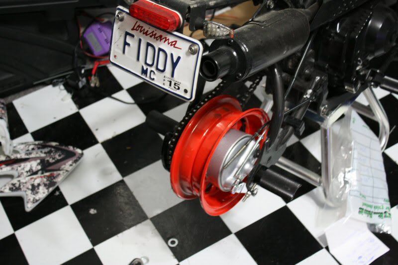

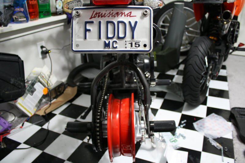

Sweet, good to hear! Tire is due in Monday so I'll put it all together. Got the wheel, hub, brake and sprocket on bike now and all fits with a couple washers. :) Even use my 50stunt chain guard.

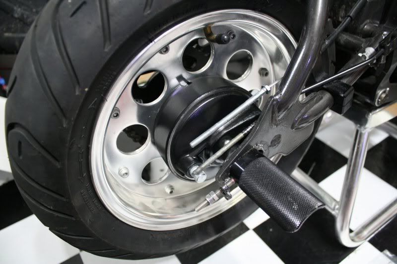

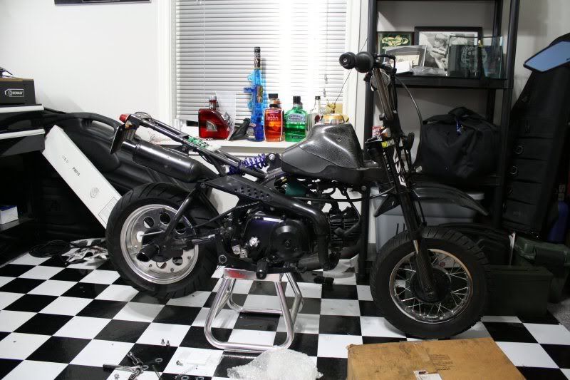

I'm sure I'll figure it out Monday when I put the tire on, but I'm curious since I have time to ask... Which half of the Z50 wheel goes on what side? This is how I have it now and I think it's right, but wanted to ask since I have a few days before hand and would rather do the tire install once. Thanks!!

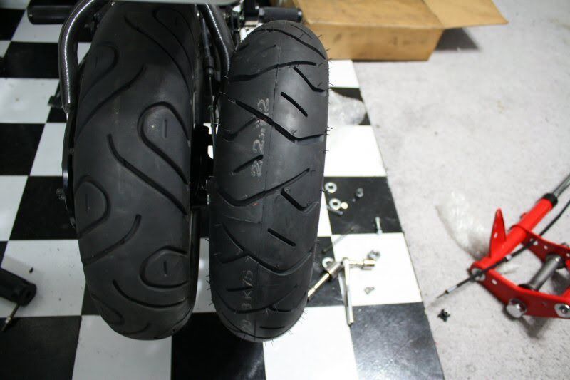

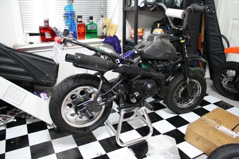

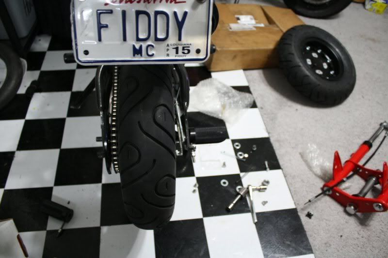

Here's some pictures of the Kitaco 2.5" wheel with a 120/70 Zippy tire on it. How it sits right now, the clearance between the tire and swingarm is VERY close, but I also have right at 1/2" worth of adjustability further back.... I"m still undecided on which size wheels I want, but pushing for 10" right now. It'll also allow me to run a disc brake on the rear later down the road if I wanted. Damn choices and I need to order something ASAP so I can get this stuff back together and try it out!
4.00x8 versus 120/70-10
