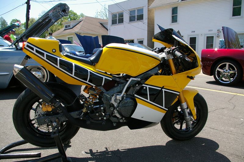

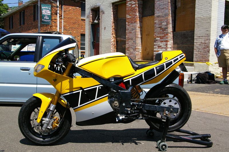

Here's my build I hope to have it on the road early next year. I started on it about 5 years ago then my daughter was born and toys weren't a priority anymore. Blew the dust off a few weeks ago and decided it was time to get it finished. It's a 1990 YSR, 95 YZ250 motor with WR250 stator/lighting coil, shortened KX85 forks with ninja 250 springs, scooter shock in rear with shortened ninja 250 spring (might find better shock still), vortex clip ons, ninja 250 radiator, modified micron RZ350 pipe, R6 rear sets (maybe), hand made 4" over swingarm, trail tech vapor, ninja 250 caliper up front, stock fairings unless I get lucky and can find a set of the R6 fairings.
I'm going to run the pitster supermoto mag wheels so I can have a rear disc brake (and they look really cool) but they won't be back in stock until first part of December. So I'll have to wait until then to finish the front and rear brakes and swingarm
Here's some pics of the progress

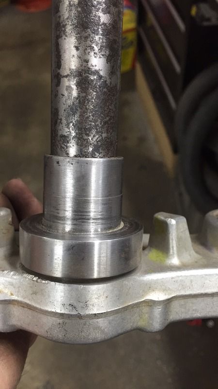

I know its a bit older but wondering what happened with your build. I too have resurrected my ysr250 (wr250) build. Wondering about your kx85 fork use. Is the stem for that triple fit the same bearings as the ysr neck or...what did you have to do toe get that all to fit?
Thanks
19 Posts
Discussion Starter · #17 ·
Hey I'm still working on the bike. I let it sit for a long time but it will be finished this year. I used the kx85 triple tree with all balls tapered bearing and a custom lower bearing adapter. I'm actually switching to yz85 forks soon so I'll post a pic of the lower bearing spacer when I pull the front end apart
