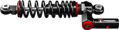

Take a pic of the resi from the angle of the valve and i'll be able to tell you. based on that pic, its the m4 not a6. if you take the other pic, i'll be able to confirm. you can text it to me
1,088 Posts
That's what I was going off of.

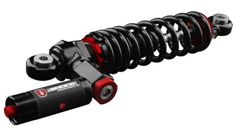

The A4 doesn't look like it has that red knob sticking out as far as her shock does. Here's some examples:
M1-A4
M1-A6
1,317 Posts
Thats not the same valve cap. Its not a knob or an adjustment. Its a standard threaded valve cap like what you put on the valve on your tubes.....
It also does not have the highspeed compression allen adjustment, only the low speed is shown based on that pic.
Thats the main give away that its an a4.
if she send me a pic of the other end of the resi, there is another hex adjustment for the external resi volume adjuster. you need a 10mm deep socket to adjust it.
i know my ****
1,088 Posts
Cool I learned something new today. I have never used a shock with a resi on it before so I didn't know it was just a cap, I assumed it was a knob.
I didn't really think to look at the adjuster on the resi.
