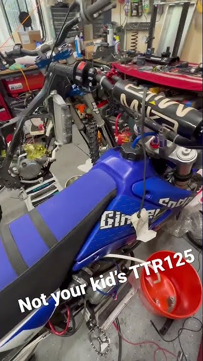

Alright so got a little work done on the bike yesterday. Going to button some stuff up tomorrow hopefully.
Got the new cam sprocket installed. I hate installing these things. It’s a tight fit to get everything lined up due to the sprocket being almost the diameter of the opening and just not a lot of wiggle room to get the chain on. Also the adjustable hub is a super tight fit into the cam itself, it being a little thicker takes away some room as well. All in all it probably took me a solid 45 minutes to have the top and bottom end lined up properly with the chain in the correct tooth and then get it onto the shaft.
Motorcycle Fuel tank Motor vehicle Automotive tire Automotive lighting
Tomorrow going to weld on the new silencer adapter and hopefully get a nice spacer made up on the lathe. Also the shock mount which I had red filled lower has ovaled out. So I made up some spacer/washers to weld up on the mount and reinforce it. Hopefully get it up and running this week.

Back from the dead… again. I’ve been working on the bike off and on. Was still burning oil like crazy despite changing the valve seals. Pulled the engine other than looking like it was burning oil nothing appeared wrong majorly. I’m 100% sure I assembled the original oil ring set incorrectly so it wasn’t sealing. I was younger and dumber. So new top end and gaskets installed with rings setup correctly. Priming the oil now and we will see what happens. Installed the new silencer. Still need to repaint the exhaust but it works for now. Cross y’all’s fingers. If the engine is good I have some plans for the suspension to get a bit more dialed in.

Well fired it up. Initially smoked a bunch but just until all the old oil was burnt off in the head and in the exhaust. Also clutch is working fine. One downside is some smoke from the crankcase but not too bad. I need to dial in the jetting. Running a keihin PE28 from a CR80. Had a 150 main in but the AFR was about 9:1 (had some blue smoke for sure) so dropped down to a 145 and now at idle we’re at 12:1. At half to full throttle it’s leaning out a lot like 18-20:1 and bogging. Currently running a 155 main but it’s not enough. I’ll try a 170 and see where it lands. Possibly raise the needle one clip and go from there. Either way getting progress and confidence this thing will finally work sooner or later.
