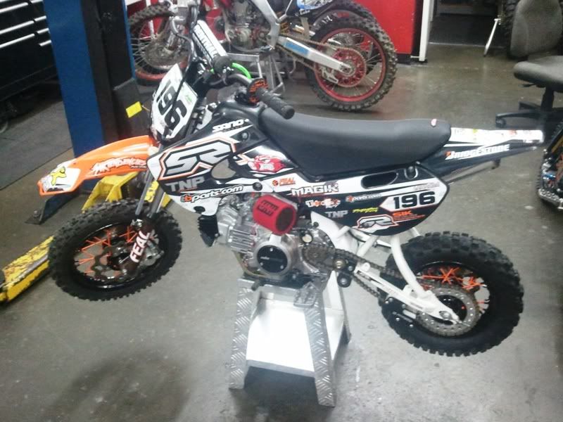

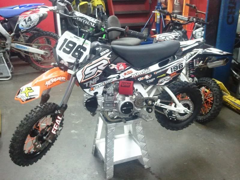

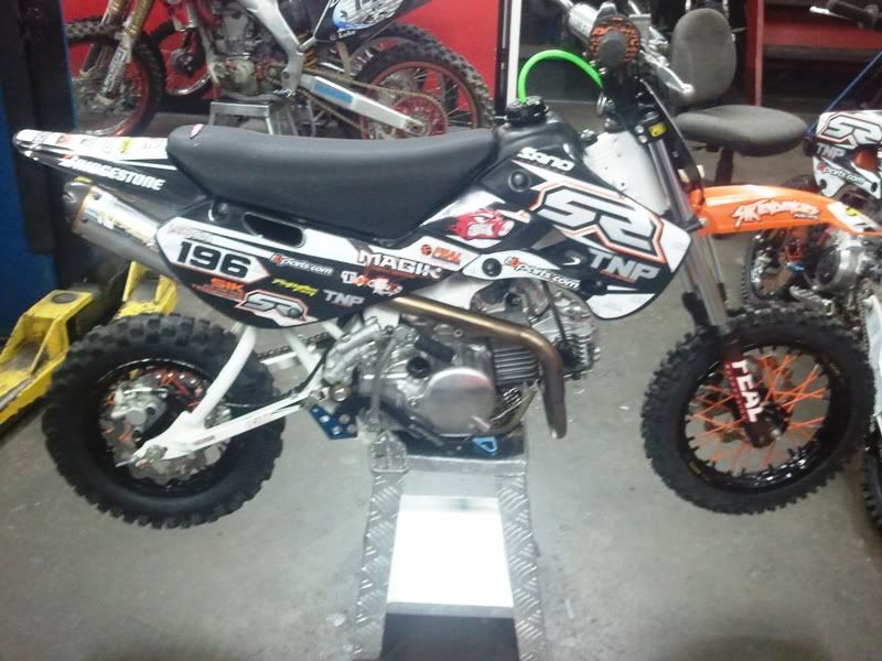

Finally finished her up today and shot some pics,,, here is all I have done to her and below are some pics:
Engine:
  1. TB 55 stroker crank
  2. HD output shaft
  3. Classic Honda billet 2nd gear
  4. TB 4th gear shift drum
  5. Takegawa 138+R piston with stock cylinder bored out to a 138
  6. V2 Roller rocker head with Takegawa S20 cam
  7. VM26 carb with reverse manifold
  8. Starter boss cut and removed from cases and rewelded back up to be able to run a rear facing manifold
  9. Two Brothers Exhaust
  10. Stock clutch basket with Magura hydro clutch and Takegawa primary gear
Suspension:
Front:

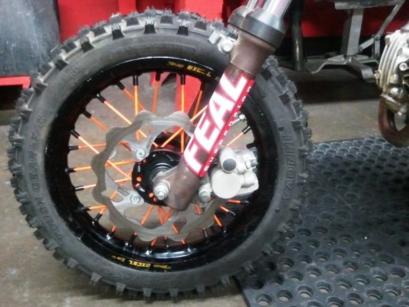

  1. Two Brothers Dampening rods
  2. Race Teck Emulators
  3. Two Brothers Heavy duty Mild springs (in one leg and stock in the other)
  4. Anodized fork legs Pro Circuit brown
  5. Feal Suspension revalve
Rear:

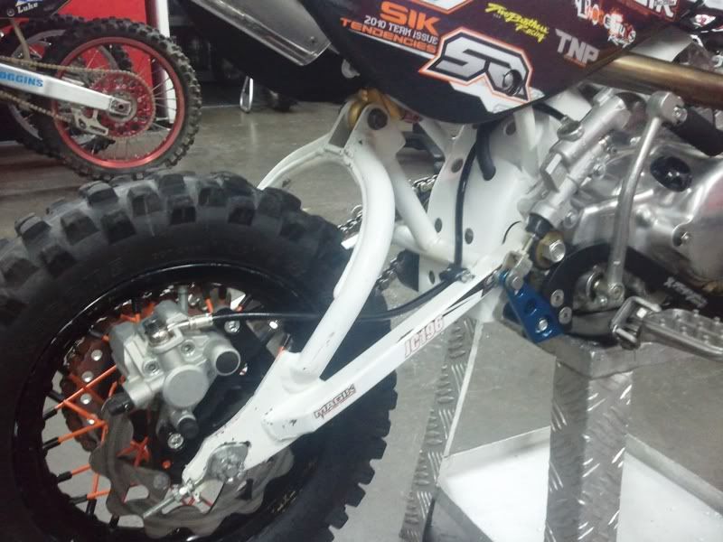

  1. Removed the bushings out of the swingarm and replaced them with actual bearings
  2. Elka shock
  3. Revalved by Feal Suspension
Misc:
  1. KX65 front and rear wheels (Rad mfg Eagle black ano hubs and nipples/black excel rims/HD spokes and they are 10" rear and 12" front)
  2. Galfer/STR front wave rotor for KX65 front wheel (200mm)
  3. Galfer rear KX65 wave rotor
  4. CR85 caliper and adapter for Stock forks with wheel spacers
  5. YZ250f front mastercylinder
  6. YZ250f rear master cylinder
  7. KX65 rear caliper

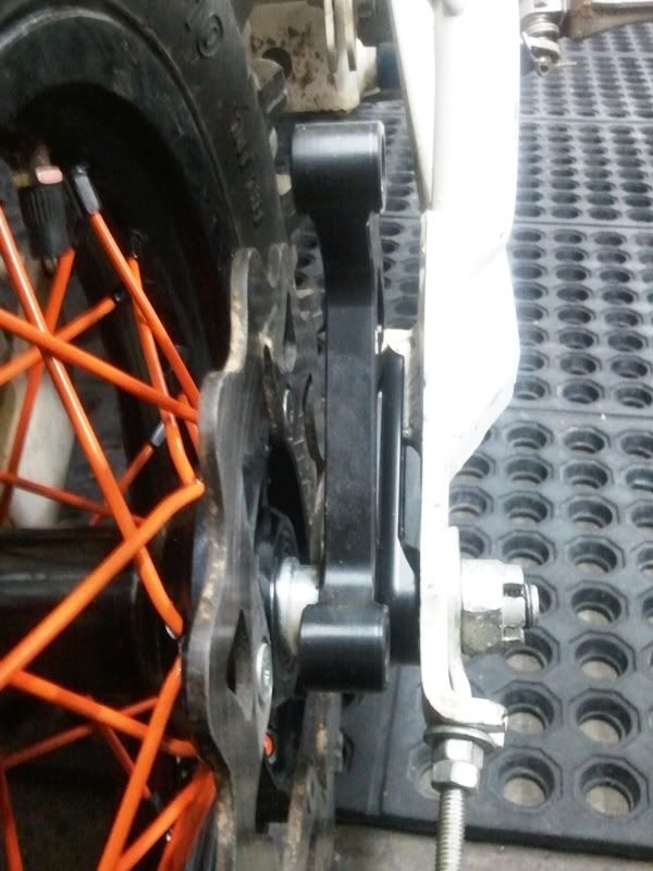

  8. STR KX65 rear disc brake adapter kit for stock swingarms/a-style swingarms
  9. Welded in tab to swingarm to hold rear caliper adapter
  10. Renthal Allessi bars
  11. Pro Taper triple clamps
  12. STR Graphic kit with KTM front orange fender and black front number plate/ and UFO KLX110 black plastics back
  13. Two Brothers Tall seat with N-style gripper seat
  14. Two Brothers Over the top in Blue
  15. Two Brothers Footpeg bar and Fastway pegs
  16. Two brothers Chain Guide with Chain Roller as well
  17. DID 420 GOld Chain
  18. STR Billet Cam Chain Tensioner
