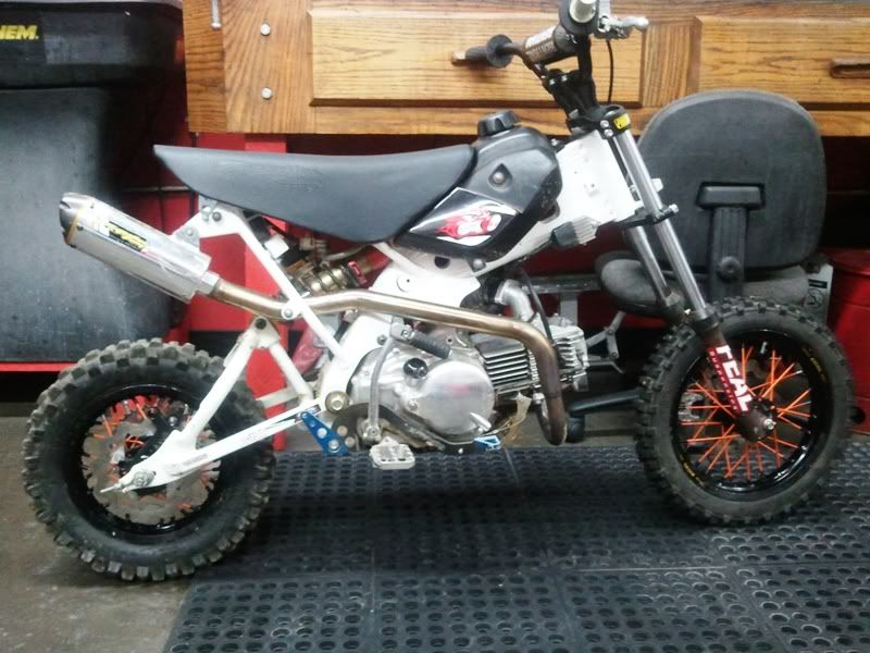

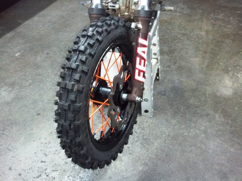

I just started to switch my stock mod bike to a full disc brake stock mod bike,, I will show my progress as I start to get more of the parts in that I need (Rear YZ250f/450f rear master and front master, and front cr85 caliper). But here is the KX65 front wheel I just laced up and spaced out for the stock KLX110 forks.
Once I get the rear wheel laced and trued tomorrow I will show pics of that also.

here we go again!!!LOL.. hey is that thing going to sit to low?
9 1/2 inches off the ground so I don't think so,, I think the mod bike sits lower! hahaha
Not to mention the fact that the difference between a 12" rear and a 10" rear at the rim is only 1" of ride height. Then factor in the extreme rear tire which is huge,, I bet it only makes the bike sit about 1/2" lower then a 12" rear would sit. Same for the front with the Innova tire.
