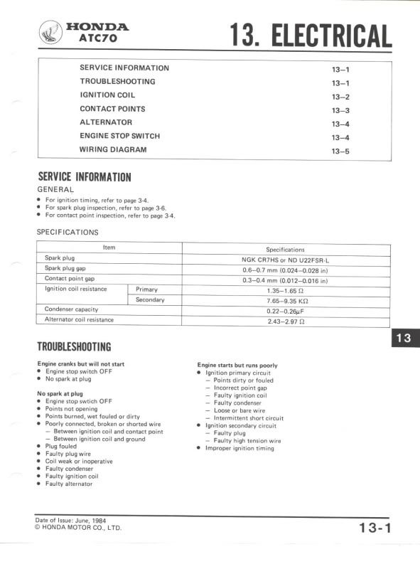

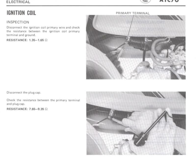

Anybody have specs to test it?

so I test the coil..... zero resistance.
Just for ****s and grins... I test a brand new 72' z50 coil. I get zero resistance on that too. wtf
