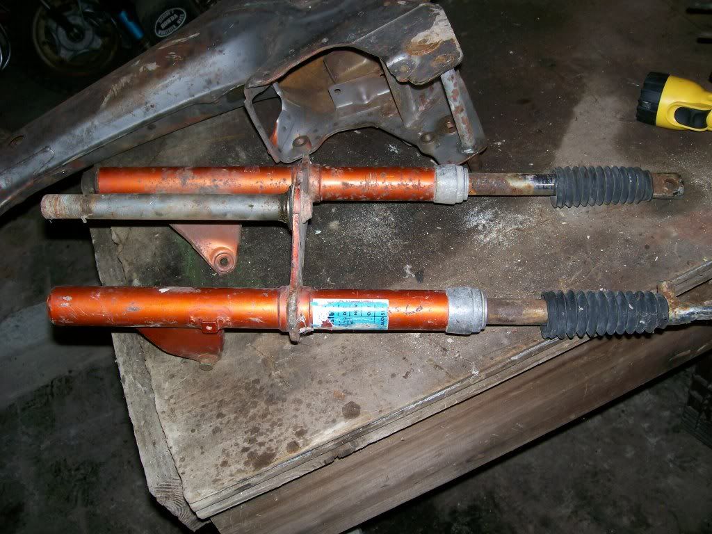

i'm starting a restoration and was wondering if its possible to rebuild the old forks since they are in bad shape....i dont know how to take them about...here are some pics

Yes you can definetly do some work to them. You can get new bushings, boots and other parts if you need them. The silver piece between the upper and lower parts of them just unscrew. Then everything just pulls out. Just put grease on the springs when you reassemble so they dont rattle.
