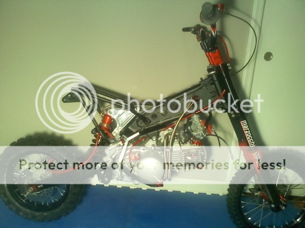

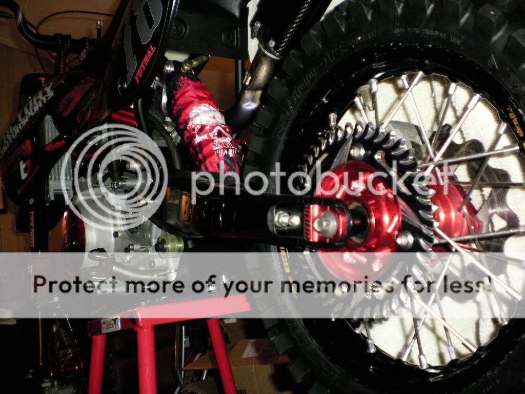

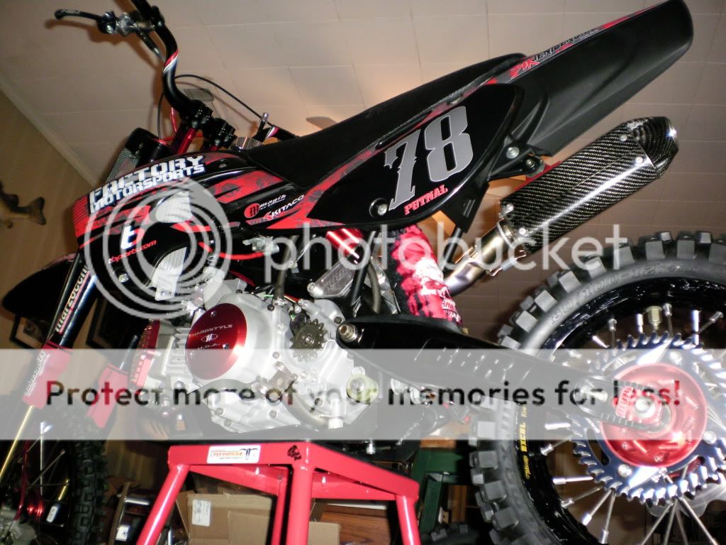

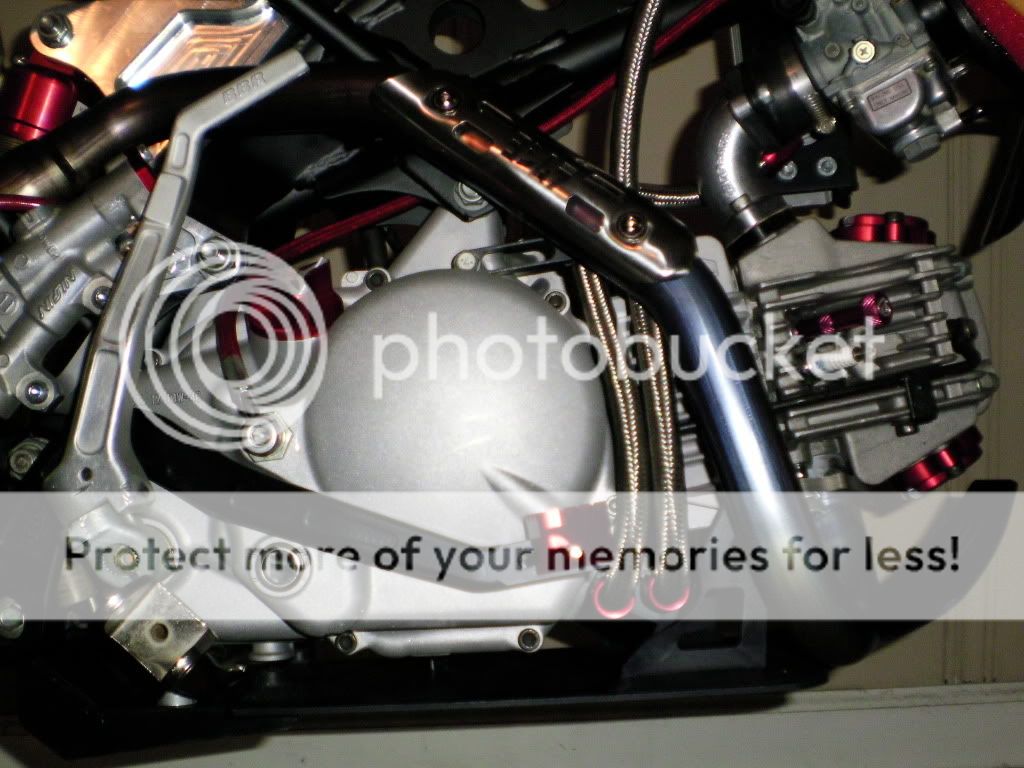

THE ONLY PARTS THAT WERE NOT BOUGHT USED OFF OF PLANET MINIS ARE...
The seal savers, outerwears filter and shockwear, red master cylinder caps, the black asv lever, the black bolt kit, graphics, a chain guide, a vortex sprocket, v2 head and the motor. Other than that its all Planetminis built.
SO THANKS FOR THE HOOKUP TO EVERYONE I BOUGHT FROM AND ANYONE WHO HAS A HAND IN RUNNING PLANET MINIS
SUSPENSION
-POWDERCOATED FLAT BLACK FRAME
-NEW STYLE-DUAL COMP/REBOUND MARZOCCHI'S TUNED BY KEVIN BRULE AT CYCLE WERKS SUSPENSION
-EASTON OVERSIZED 1 3/8 EXP BARS
-BBR SUPERCOMP SWINGARM, HAND POLISHED THEN HARD ANO'D BLACK
-ELKA SHOCK WITH RESI
WHEELS AND BRAKES
-RAD EAGLE KX65 HUBS
-BLACK PRO WHEEL FRONT RIM
-BLACK EXCEL REAR RIM
-GALFER WAVE ROTORS
-HD SPOKES
-DUNLOP MX51'S
-BLACK VORTEX SPROCKET
-STR KX65 KIT FRONT AND BACK
-RED STR BRAKE LINES
-KX65 CALIPERS
-YZ450F MASTERS
MOTOR
-TB143 KIT
-V2 HEAD WITH TB DECOMP OPTION
-TAKEGAWA S25 CAM
-MAGURA HYDRO CLUTCH
-RED STR CLUTCH LINE
-TB CLUTCH KIT
-KX65 CLUTCH SPRINGS
-BUMP START
-STR BILLET CAM CHAIN TENSIONER
-KITACO PRIMARY GEAR
-BBR OUTPUT SHAFT WITH BILLET FIRST GEAR
-CHP BILLET SECOND GEAR
-HAND POLISHED GEARS
-TAK 4TH GEAR SHIFT DRUM
-CHP BILLET SHIFT STAR
-ALL NEW BEARINGS
-RED JOKER BILLET THROTTLE
-MIKUNI VM26 606 CARB
-RED FREE FLO GAS LINE
-UNI POD FILTER
-OUTERWARES PRE FILTER
-TAKEGAWA INTAKE
-SIK110'S OIL COOLER SYSTEM
-F.M.S. OIL COOLER LINES AND FITTINGS
-YOSHIMURA CARBON/TITANIUM TRC EXHAUST
-BLACK PLATED DRESS UP AND COVER BOLT KIT
-BEAD BLASTED COVERS
-RED HARDSTYLE DRESS UP KIT
-BBR KICK START
-HRC ENGINE CRADLE
-BBR SKID CUT TO FIT OIL PUMP AND CRADLE THEN RE-ANO'D BLACK
-PRO CIRCUIT SHIFTER
-BBR BRAKE PEDAL ANO'D BLACK WITH RED TIP
-TWO BROS PEGMOUNT
-FASTWAY F6 PEGS
MISC.
-F.M.S BBR CHAIN GUARD PC'D BLACK WITH BLACK PLATED BOLTS
-RED/BLACK N-STYLE GRIPPER SEAT
-VENTED FRONT NUMBER PLATE
-RED ASV C5 BRAKE LEVER
-RED ASV ROTATOR CLAMP
-BLACK ASV C5 CLUTCH LEVER
-BLACK ASV ROTATOR CLAMP
-BBR GAS CAP
-RED MARZ BAR RISERS
-PRO TAPER PILLOWTOPS
-RED OUTLAW RACING CAPS FOR THE MASTER CYLINDER
-NEW TAPERED STEERING STEM BEARINGS
-NEW SWINGARM PIVOT BEARINGS
-TBOLT FENDER BRACE
-SEALSAVERS
-SHOCKWEARS SLEEVE FOR THE ELKA
-CUSTOM F.M.S. GRAPHICS KIT FROM MAGIKSC
Finally broke down and got a good helmet, thought it might come in handy especially now that the bike will be fast haha
I'm going to try to get the bike 100% finished in the next few days
I have been out of it because of problems with Mom's health.
Thank you all for the thoughts and prayers
I will post better pics of it complete soon.

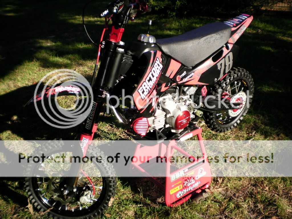

2,810 Posts
My Pink Machine!
CHASSI
2004 Stock Frame
Stock Front Forks with BBR Top Clamp and Seal Savers
Stock Swingarm w/ Fox Float MXR (Powdered Black)
Black Pro Wheels with Powdered Black Nipples, Hot Pink Spokes, Black Hubs
BBR Tall Seat
Black Pro Tapers XR 50 Bend with Red ASV and TB Billet Throttle, White Grips, Rosckstar Blister Busters
MOTOR
Stock Motor with TB Cam and Pod Filter/Bracket
Yoshimura RS2
TBR Kick Starter
MISC
Black UFO Plastics w/ Custom Magiksc Hart and Huntington Graphics
Hardstyle Dress Up Kit
Black Red Baron Mount w/ Fastaways
Two Bro Black Sprocket
Sunline Shifter
SIK110 OTT
BBR Gas Cap with White Free Flo
BBR Skid Plate
Fender Brace
Re Polished Black Cases
Fender Brace

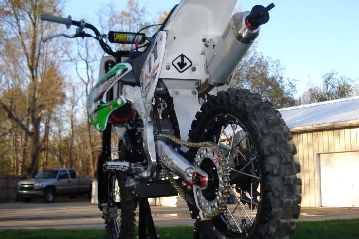

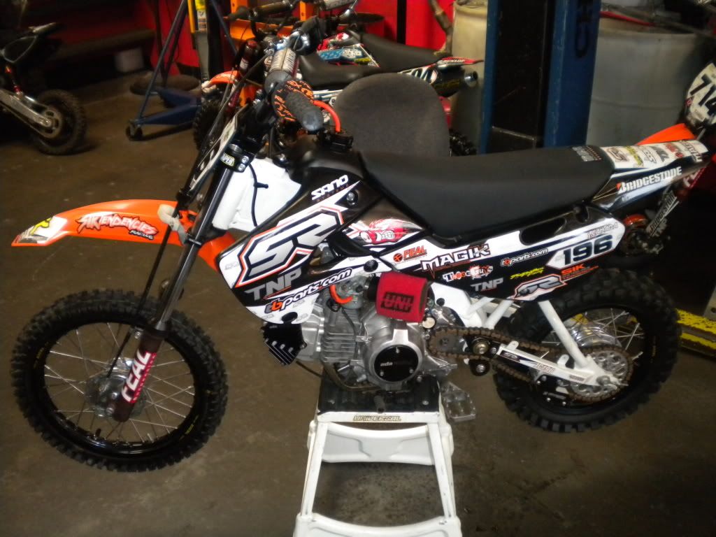

2008 Thumpstar TDX125 Super (Nobama #93 Supermoto spec bike)
-Trail Bikes 146cc big bore
-Trail Bikes High comp piston
-Lifan Big Valve Head with polished intake
-Trail Bikes Race cam for BVH
-Estart removed
-Modified big bore exhaust
282 Posts

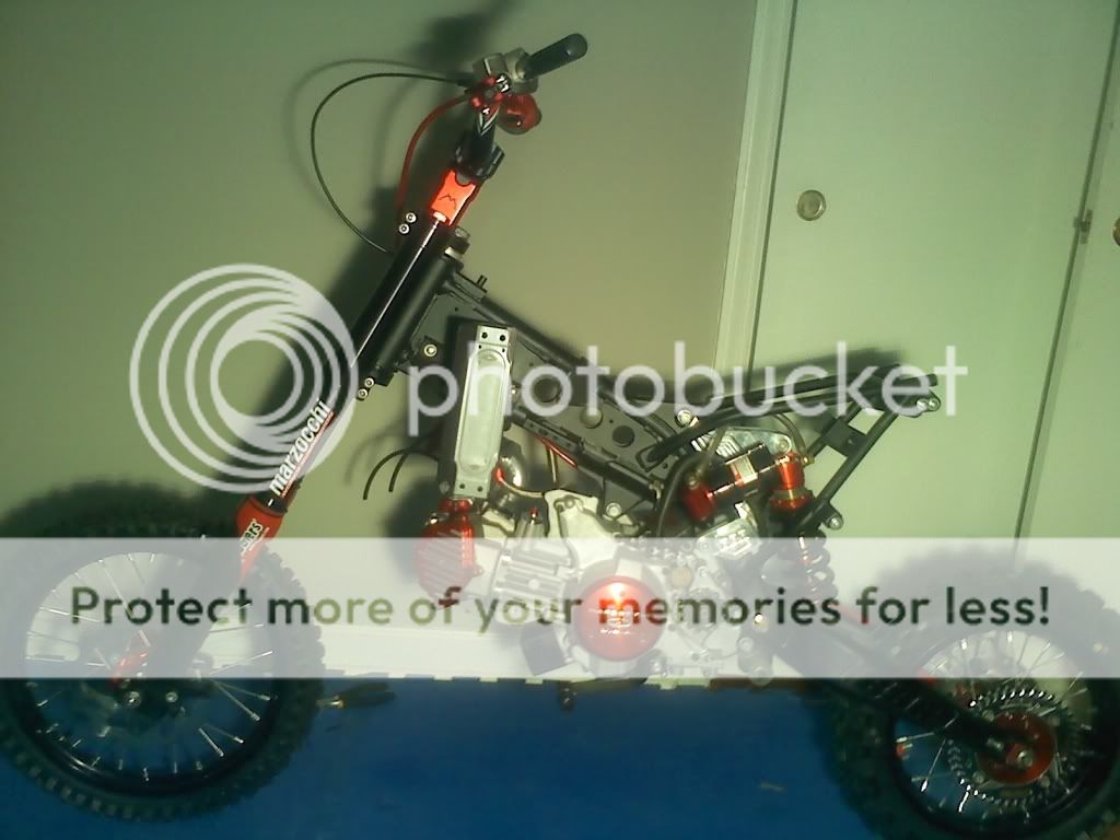

1,164 Posts
150+r
Tak 6 disc / modified inner hub by myself to keep steel inner sleeve from spinning out
close ratio 4 speed
lightened flywheel
Tokyo Mods cdi
U-Flow
Pro circuit shifter
Marzocchi forks w/billet bottoms...no adapters needed for 65 brake/wheel setup
65 rear wheel/brake setup...rear brake adapter made for previous owner by Motorcycle Hall of Famer Joe Bolger....kinda cool i thought
Custom mud flap setup
SDG seat
Pro Tapers
KX throttle
15/44 gearing
Team MBR/Magik Graphics

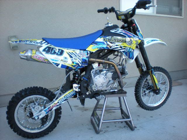

1,901 Posts
heres mine...rode it for about 2-3 hrs today:D
Billetware klx cradle frame......1 of 3 made
CHP billet swingarm with Fox Podium
Marzocchi forks......black coating on lowers/ anodized blue adjusters
Tri Star tripple clamps
FMF 4.1 Ti pipe
Two Bro kick starter
Two Bro oil cooler
Two Bro OTT brake lever
Two Bro pegmount and pegs
Two Bro tall seat
Kx 65 brakes with Gafler oversized rotor
Acerbis plastics with Magik graphics
Motor.......
TB 143 with V2 Decomp head
VM 26
4th gear, output....blah, blah, blah
Takegawa clutch
lots of blue bling and killer dress up kit
I had fun putting this bike together.....learned alot. Thanks to all the peeps i bought stuff off of to get this build done...check her out:fing02:

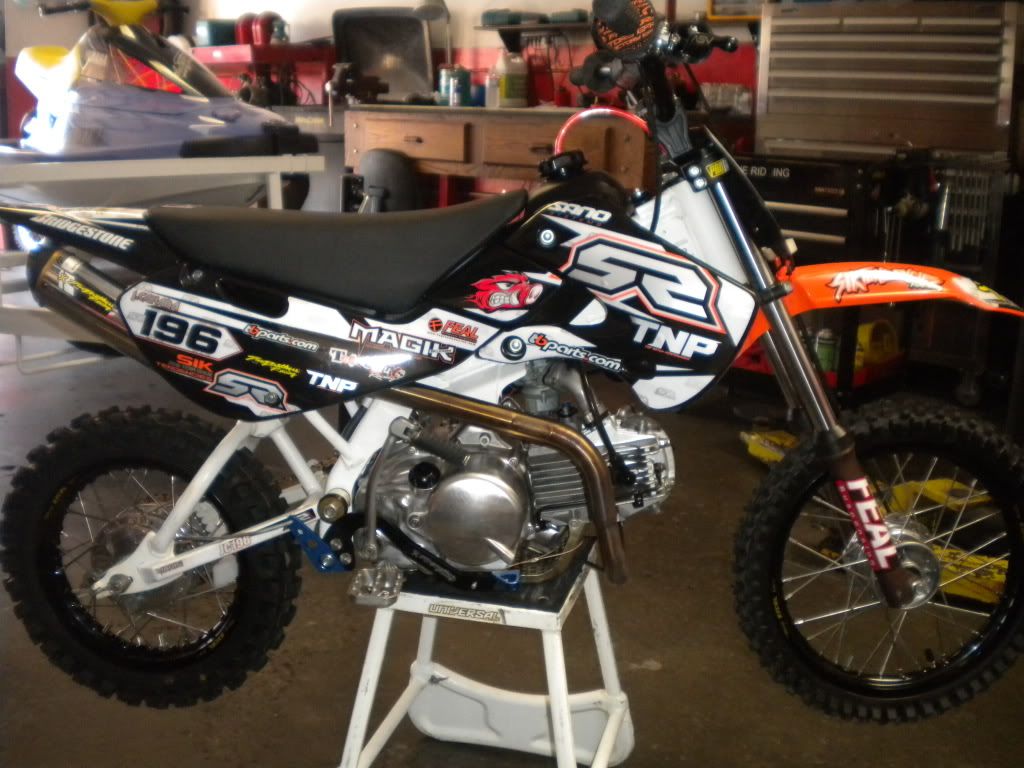

781 Posts

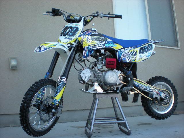

My klx110 it has some mods but looking to do alot more to it
kamakzi 143 big bore
kamakzi cam
mikuni 26mm carb
pro circuit t4 exhaust
TBR foot pegs/mount
chp clutch
pro tapper bars
magik graphics with white ufo plastics
cat 5 cradle mount
two bros shifter
ishock m1-A4
bbr tall seat
bbr u flow
tbr rev box
pro wheel red rims

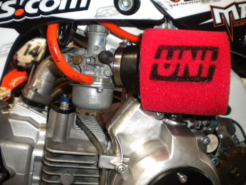

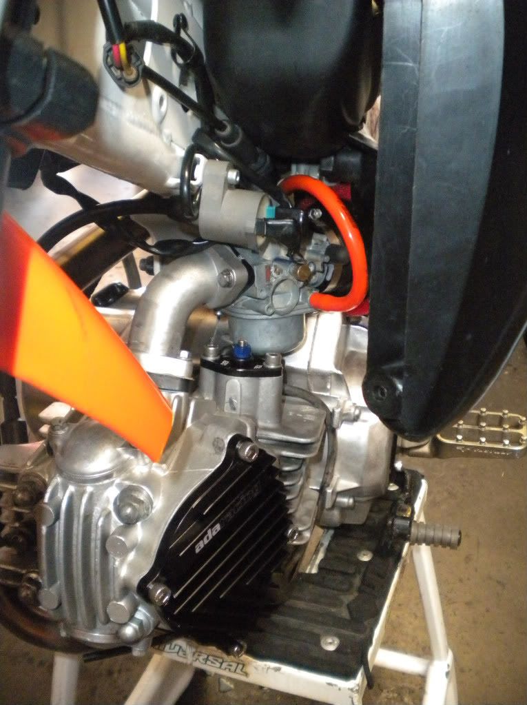

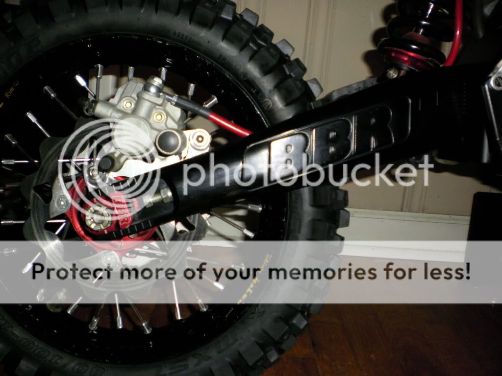

5,278 Posts

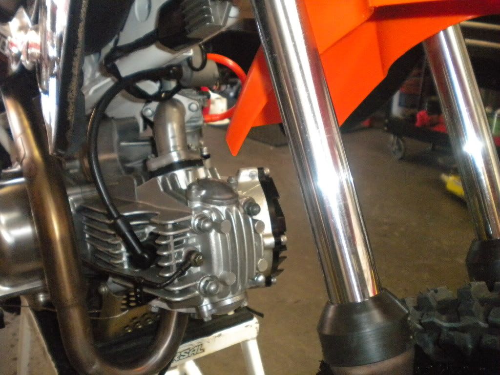

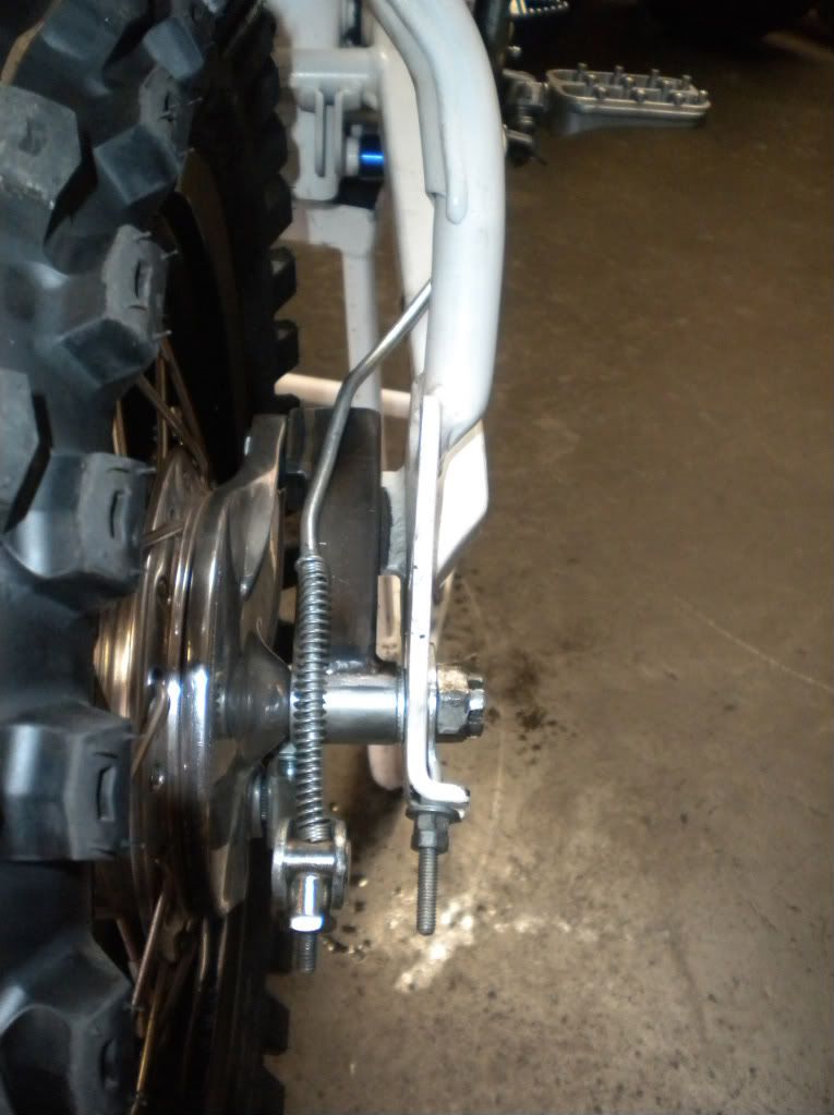

Here is my Stock mod With rear facing manifold/carb for Jake Canada:
Here is the breakdown:
Engine:
  1. 138+R piston with bored stock cylinder
  2. Big Valve stock head :)
  3. Trail Bikes 55mm stroker crank
  4. Trail Bikes 4th Gear shift drum
  5. Trail Bikes HD output shaft
  6. Classic Honda's Billet 2nd gear
  7. CHP billet shift star detent
  8. Polished Cases (Clutch and flywheel)
  9. STR Billet Cam chain tensioner
  10. Rear facing manifold with cases cut and welded
  11. Two Brothers M6 pipe
Suspension:
Front:
  1. Race Tech Gold Emulators
  2. Two Brothers Dampening rods
  3. Two Brothers Mild HD spring in one leg and a stock spring in the other
  4. Pro Circuit anodizing on the lower legs
  5. Feal Suspension revalving and installation of forks (They feel bomb!) ha
Rear:
  1. Elka shock w/ remote resi; Feal Suspension revalved for stock mod application
Other:
  1. Renthal Black Allessi bend bars
  2. Pro Taper Rockstar Grips
  3. Pro Taper top clamp (black)
  4. Tappered Bearings
  5. Powder coated white frame
  6. KTM Black Front Number Plate
  7. KTM front Orange Fender
  8. Black UFO plastics with STR Jake Canada Graphics
  9. Extended front brake line cable and ASV lever with dust cover
  10. Rear Brake Torque arm eliminator bracket with welded on tap to the swingarm (allows you to remove the arm that gets bolted to the drum brake and the swingarm)
  11. Two Brothers Over the top brake pedal
  12. IMS Cut and welded shifter
  13. DID 420 gold chain with 15/37 gearing
  14. Polished stock hubs
  15. Buchanan HD spokes
  16. Black Excel rims front and rear
  17. BBR tall seat
  18. Two Brothers Chain Guide
