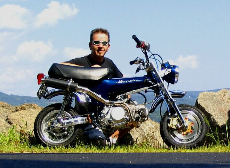

Here's mine so far...Will post again once the Tak motor is in there. Couple more minor mods in the works also. It's a labor of love or love of labor ! :D
93 CT
G-craft swinger
NSR forks with G-craft triples
G-craft rims with Heidenau sneakers
Brembo caliper with Spiegler line and CMX250 master cyl
Temporary engine: 125 GPX-TB146-Cat5 head
CRF50 peg brkt with Kuryakin pegs
50Stunt sidestand
Daytona steering damper
"Shock" turn signals
Kitaco stainless/carbon exhaust
CB250 "Nighthawk" bars
Daytona shocks
Lots of chrome from "Kickstands and Wheelies"
Painted by Mikes Auto Body Woburn MA
Lots of help from "Motoshop Z"
More to come : )

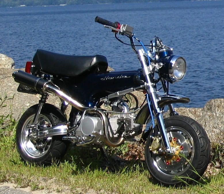

85 Posts
This is mine. The bike started it's life as a 1990 ST50. I've had it for almost eight years now, and it went through quite a few changes.
The current engine is a homebuilt 124cc twin cam: takegawa 54mm stroke crank, 54mm bore, Daytona DOHC head, Daytona 5 plate wet clutch, takegawa 5-speed gearbox, etc...
The forks are shortened honda nice forks, custom made hub for disc brake, 4" honda CY50 rear rim, takegawa Hyper street down exhaust, altered seat, rev counter and temp. clock, and quite a few smaller changes. I've put CT70 decals on, just because I like the look of them, and they're different to what you would usually see here in Europe.
I also have a UK spec original 1972 ST50 K1. Untouched and as is, just over 2000 miles, the only thing I recently did was build a 'stealth' engine for the bike (not in pics yet) . Honda based, 4 speed semi, 88cc kit, 70 head, uprated oil pump, C90 clutch, 18mm carb with original air filter and exhaust. Looks standard but goes quite well.
My third dax is an original 1973 ST70 Lady Dax. needs some TLC, but I'll probably keep it as it is
Cheers,
Godfried

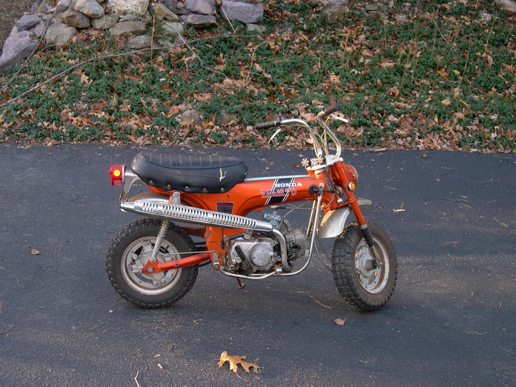

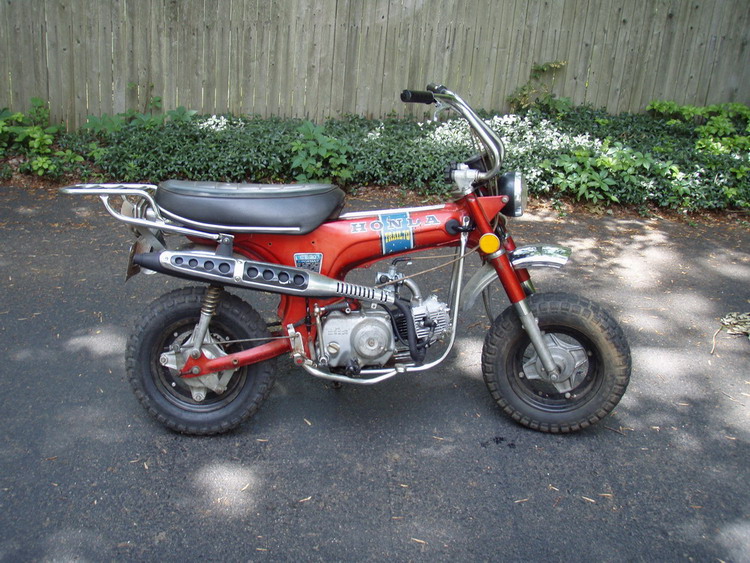

568 Posts

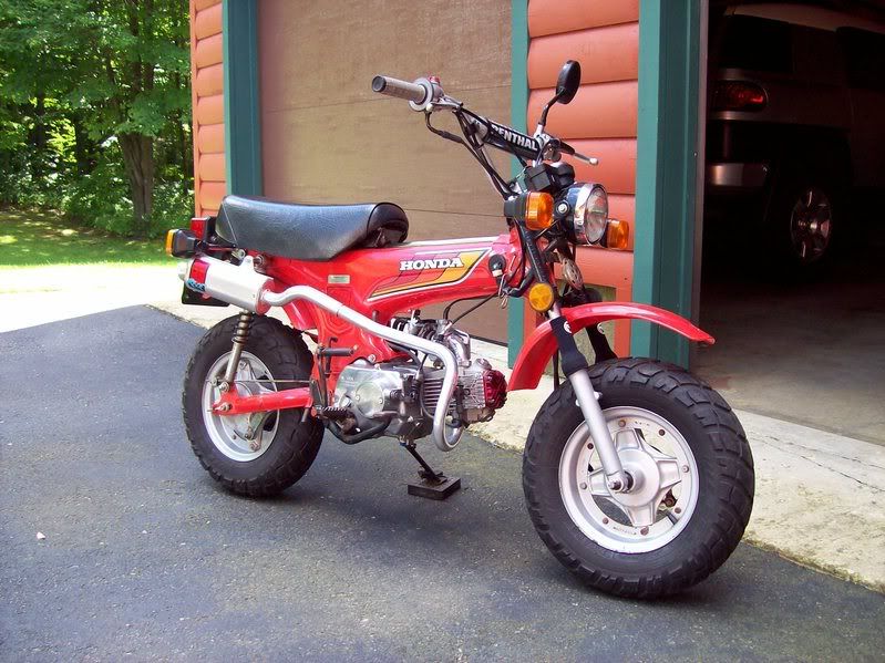

My '72 Work in Progress . . .
It currently has a CRF exhaust, cheapie front disk brake setup, stock motor with a manual clutch kit, Pirelli street tires (shown in the first picture), aftermarket seat (shown in second picture, some semi-custom bars and Honda Shadow mirrors (shown in the first picture).
It will be coming apart hopefully this winter for a complete redo - lots of plans for the bike. I have tried a bunch of different things out to see what I want for the final build, that is the reason for the differences in the pictures. :rolleyes:

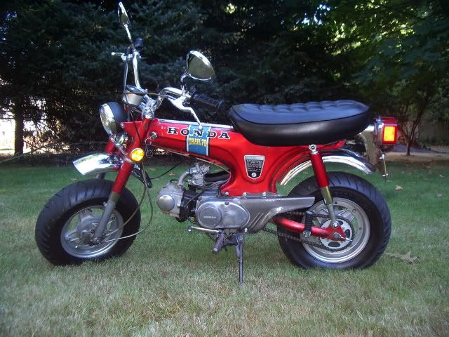

917 Posts
dirttrackin280h said:

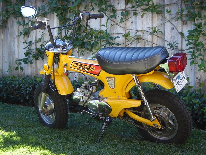

My 1979 Honda CT70
DRATV 88cc cylinder/piston kit and 20mm carb. setup.
nice ct, your makin me want one.

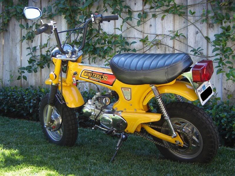

5,673 Posts
How about a CT70 with a GPX177V2 in it?
So, here is the latest incarnation of Schoolbus.
It now sports a GPX177 V2 on it.
Daytona Windscreen
Takegawa Tach
Other odds and ends. I still need a pipe for it which will be ordered at the end of the month. Also going to replace the large turn signals, that, while are very visible, are quite ugly.
Gotta be honest here...it does not have the low end torque like my Jialing 157cc with the 61.5 stroke, but it looks to be a winner.
Here's a few pics.
