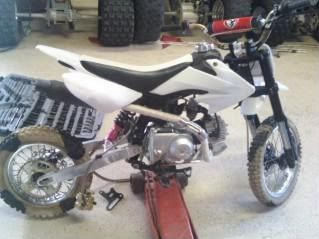

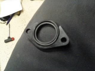

ok im new here and i figured i would come ask ur guys opinion... i got a bike, not sure of the brand, with a pantera 90cc motor in it. it used to have a 125 but the previous owner got rid of that. now my problem is it wont start... i tryed adjusting it for the colder wheater by lowering the clip, which is when it quit starting, so then i raise it two notches, nothing... so i put it back to stock and nothing... i have a broken gasket between the carb and manifold and might it be latting too much air in?? oh and looking at the jets could it be possible that one really said 72??

its one of those lame plastick ones thats more of a spacer... its black and has a rubber seal on it... i just tightened it too tight and it cracked...
cracked all the way thru to the intake cavity???? you can take a bit of silicone and fill the crack in...let it dry and then put it on...that is a temp fix

ok heres the bike
heres the gasket in question

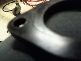

and heres the crack
and you can see in the first pic of the gasket a big chunk is missing off the top

got it
yeah...that not good..the big chunk out of it is not a good deal...well that is an insulator and you should replace it...but for the time being you should be able to mount the carb up directly....the carb should have a rubber o ring on it and that will seal to the manifold....this is just to see if the cracked spacer is causing your problems....do not run bike for a long time (ride) until you replace the insulator
