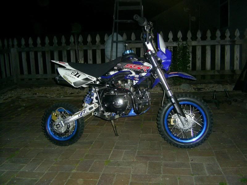

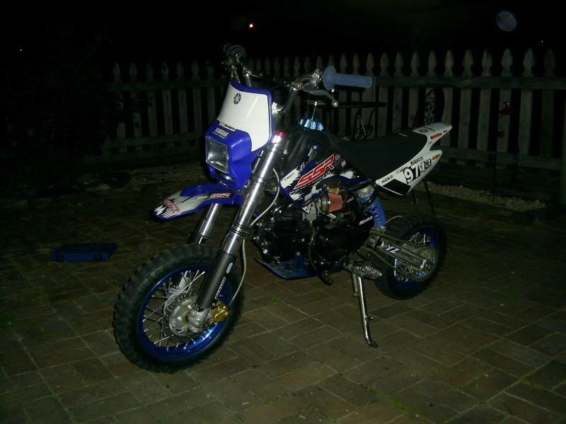

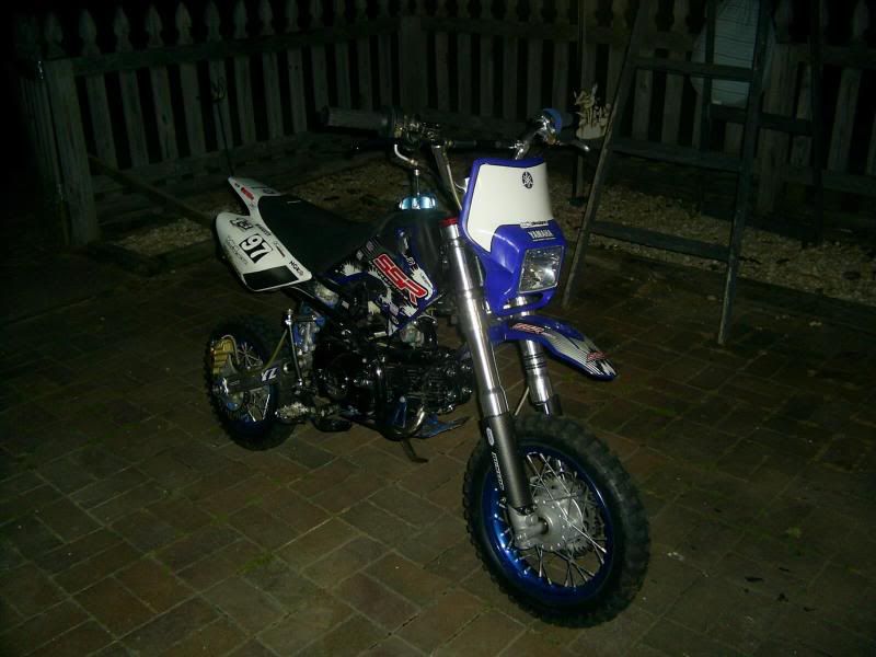

I stumbled upon some pics of a red SSR with dual headlights on the web, got me to thinkin, I bet my motor is wired for a headlight because most of the chinese motors are factory wired with stators for different intall applications like quads and stuff, and it just so happened that I had an old Baja Designs headlight that I had bought for the TTR, sure enough the yellow wire was from the stator, wired in a switch and man is this thing bright, I'm Stoked! heres a few quik pics sorry so dark!
