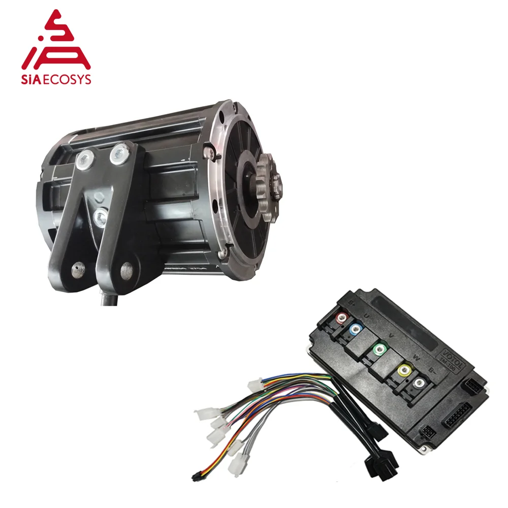

Do you have links for the motor and controllers setups?
do you mean the controller software or the "manual"? there isn't one for the motor (or not that ive seen) I had a lot of help from reading the threads on endless sphere forum which sped up the process a lot

Sorry for the confusion, links to where you purchased the motor and the controller from.
Sent from my iPhone using Tapatalk
Ah no problem! from here

What happens if you get the QS MOTOR 120 2000W motor wet or muddy? Will it just wash off or will water destroy it?
I have only hosed and scrubbed it down a couple of times but and no issues yet 🤞 , on aliexpress it says the motor is ip54 rated so it should be fine to wash down but i wouldn't pressure wash it, the controller surprisingly is ip67 but I wouldn't pressure wash that either..
