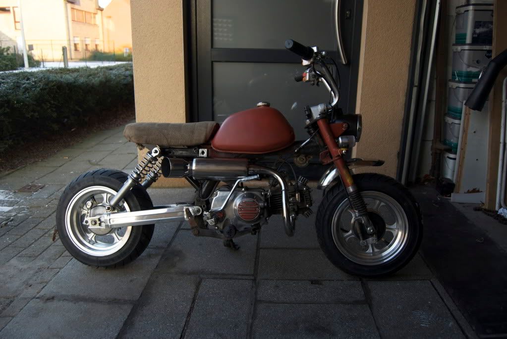

^^^^hey...that's my picture of my carpet. Get your own picture! Yes, I have them mounted on my CT70. The fronts will mount up without any special offsetting...you just need to make spacers for them. I ran the rear on a stock ct70 swinger with a 3mm spacer. ON the gcraft you need a 6mm spacer.

I know, I stole your rug, man.
