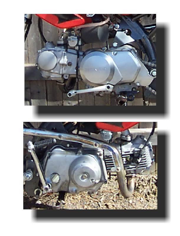

Here are two pics of a TRX70 engine converted for use in a bike. I used a Z50R kickstarter shaft (22T pinion), removed the indicator and replaced it with a bolt and rubber plug, and used regular XR/CRF clutch and ignition covers.

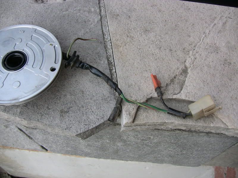

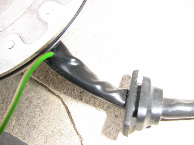

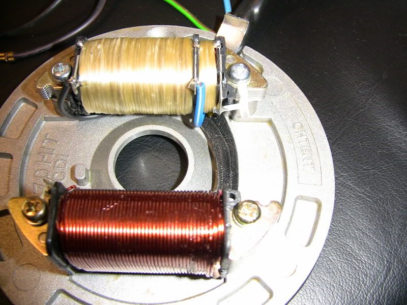

11,160 Posts

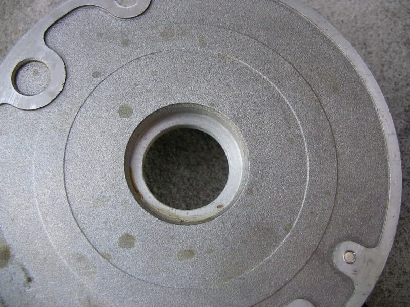

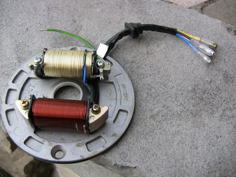

I thought I would add a few pics to this thread seeing as how I just picked one of these up and it is going in a 1985 Honda ATC 70 4 speed up motor with a TB 88 cc kit.
#!.... No crank seal
Administrator

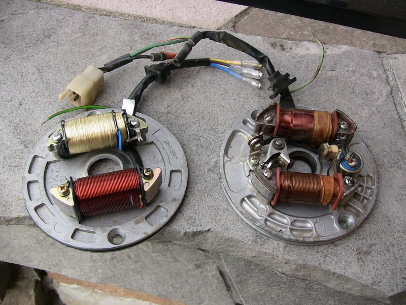

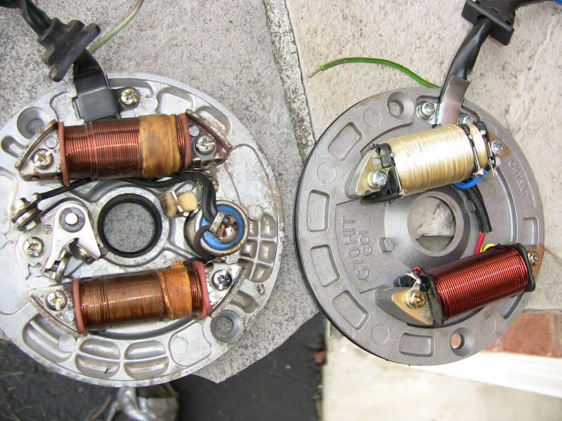

11,160 Posts
This is the points plate compared to the CDI conversion plate.6 volt cdi conversion. ATC 70 points stator plate.
Administrator

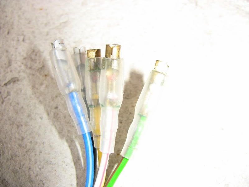

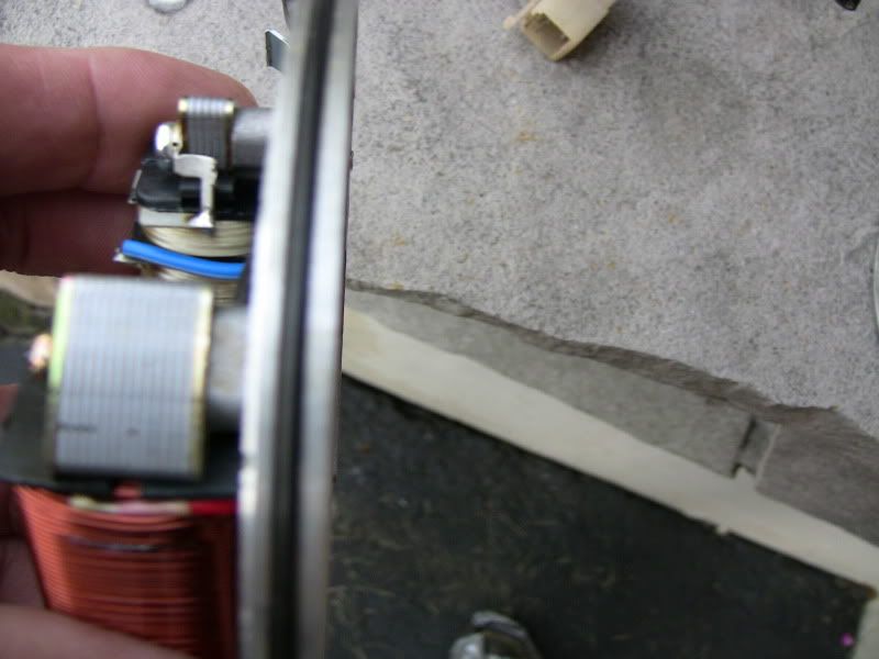

11,160 Posts
The connectors.
Neutral switch.
The new CDI six volt stator comes wound for lights like the ATC 70 motor and has nice connectors :).
