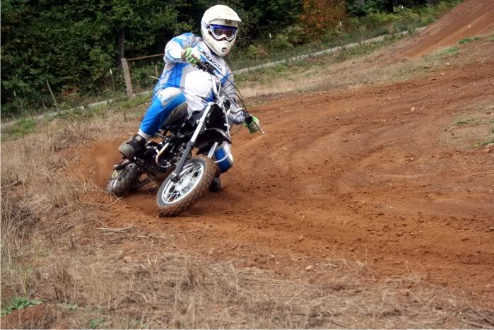

We ripped off again and started to try to get a feel for the bike. The footpegs were nice, perhaps not the strongest looking but they provided a nice platform to stand on. The bars were a little swept back for most preferences, but came at a decent height, and overall the riding position wasn't too bad. Brakes worked great, not too much grab like some models we've tried, but the disc brakes front and rear stopped you quickly. Power was not great by any means, 5.5HP at the rear wheel is what is claimed, so think a 88 class with a long swingarm.
We started to warm up to a few jumps, but in the meantime we started to really hit some corners, and noticed this bike cornered amazingly well! It tucked in hard and just railed around. We could actually go in and blast corners almost like on our race bikes. Possible reason for this could best be described by one of the pictures below. The front suspension is soft, very soft. Setup for perhaps a 110lb rider. And the shock... well, you probably have a good idea on how we feel about the shock. So with a soft front end and a hard rear end, the bike just burrows down in the corners, so keeping your body weight to the rear of the bike is essential.

Brandon was leading the first moto, lost the lead, attempted a couple jumps he shouldn't have been and bent the frame. He still went out and finished his second moto and got 2nd overall.
