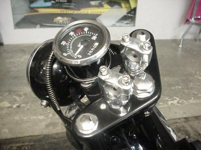

Speedo.

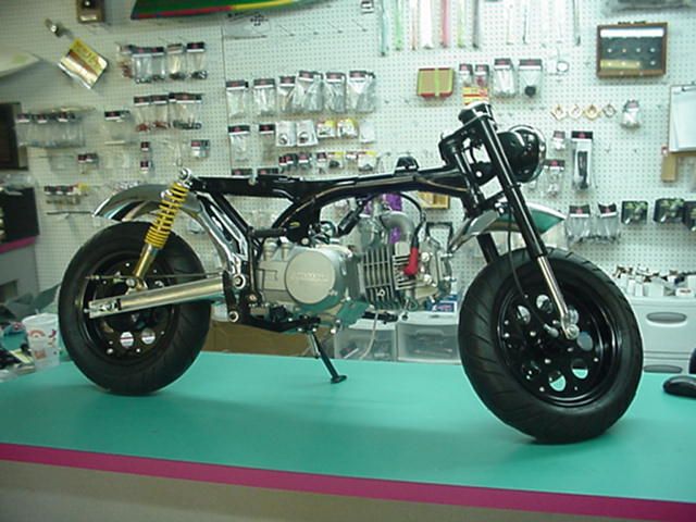

Engine Installed.
Taillight mounted and billet foot pegs.
Exhaust and Seat .
Almost done just waiting on some more parts. Everything should be here tomorrow: Longer Chrome Shocks, billet handle bar risers, tank and side cover back from painter.

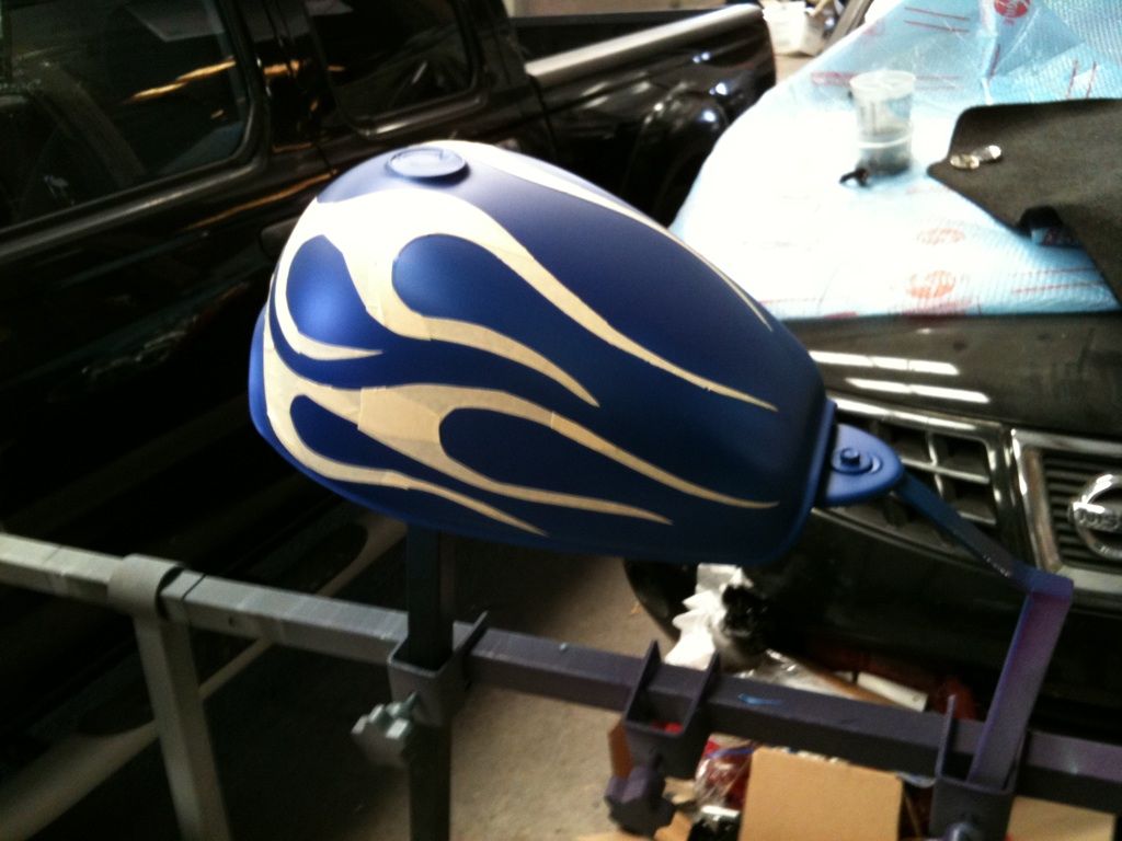

Starting on the tank.
Next Step.
Almost done first coat of clear.

Looking good!! Good choice on the black wheels with black brakes and all the other black parts. And, I'm usually not a fan of flames but those blue flames look real nice! :fing02:
EddieNewYork,
Thanks man. I was actually nervous about that also, but when Jeff put the colors on it I thought it was perfect.

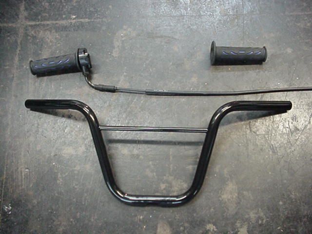

Here are the bars back from powdercoat.

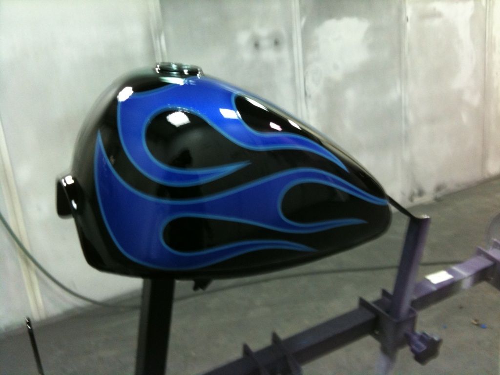

Here is the tank and side cover. I am so glad that the yellow on the side cover is now gone. When the bike was mocked up it had way too many colors. This is the tank after two coats of clear, Jeff then sanded the entire tank again and put a few more coats of clear on it.

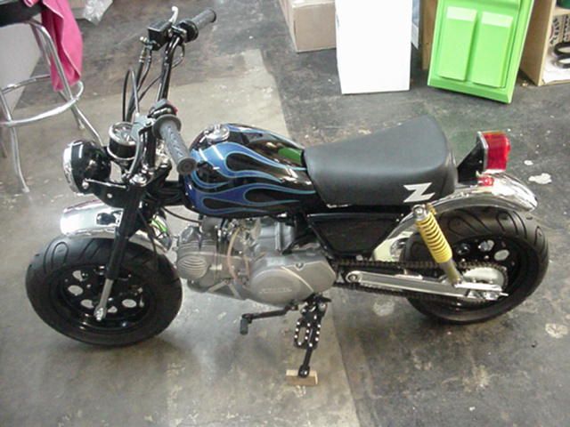

I could not wait any longer to put the bike together so I went to the local hardware store bought a polishing wheel and some new Stainless Allen bolts. I stayed late after work and sanded and polished a original set of Honda handlebar risers for about 3 hours. I had two sets of these and the ones that looked great someone had grinded them for bigger style bars and were useless. The second set I had bought a while back with a set of original handlebars. They were terrible looking as they had came off of a 79 parts bike and someone had done a bad job of painting them with a rattlecan during the last thirty years. I never thought I would be using these handle bars or these clamps on this bike that's for sure. When I was done I thought they came out great and now I don't want the aftermarket clamps and will cancel them on the order.
Here are two not so good pics from my phone, I will post better ones later today. Please ignore the short ugly yellow shocks, I should have the new chrome ones Tuesday or Wednesday.

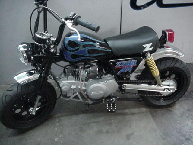

Guys,
Today was the day that project Z50RR made it's maiden voyage. It cranked up on the first kick and that was a good sign as it ran perfect and was a blast to ride. I cruised around the neighborhood for about 30 minutes then stopped to check everything and it all looked good. I let it cool off for a while and then went cruising again for about 20 minutes before I gave it a quick blast through the gears. The speedometer only goes to 50mph and I do not know how accurate that is, but it buried that pretty quickly. When I got back I checked everything again and there was oil all over the bottom of the bike. After checking everything I found that it was coming from the overflow on the crankcase. It must have done it when I finally ran it wide open for a spurt. I will have to ask terry about that. All in all I am very happy it feels nice and tight it stops really well with the front disc. It is still not 100% yet as I am waiting on a voltage regulator so I can hook up the headlight and Tailight/Breaklight and the 280mm chrome shocks so I can get rid of those ugly Yellow ones.
Here are some pics today after the maiden voyage
